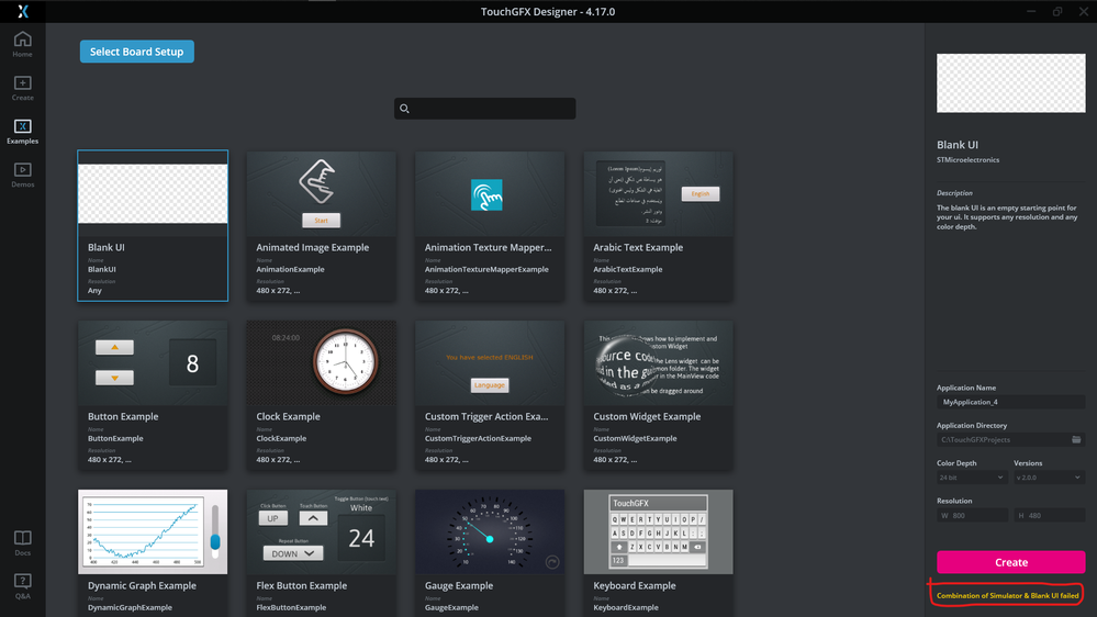

I opened a browser while trying to create a project from Examples. There is an internet connection but I have the same error "Combination of Simulator and Slider Example failed." .
I opened up the excel sheet of my project and it's not corrupted.
I tried to go with Blank UI and got this error. I have also tried Board setup and etc. Nothing changed.0693W00000BcpMDQAZ.pngI am working with STM32H743VGT6. If D-cache is enabled software can't run correctly. For example, I programmed a button to change screen but when I press the button doesn't work. If D-cache is disabled everything is working as it should be except sometimes getting hardfault.

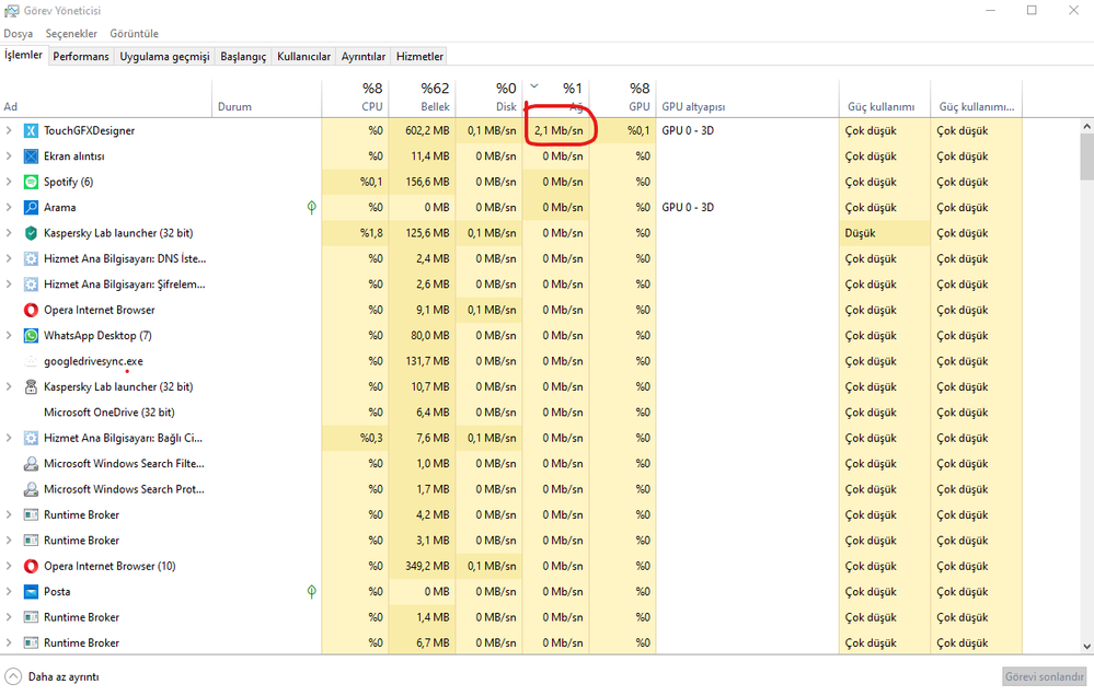

By the way it is not about the internet connection. As You can see TouchGFX is connected to internet and can downlaod packages.0693W00000BcpczQAB.png
Could you share your log file ? It is in the %appdata%/TouchGFX-4.17.0 folder.
This is very weird that you cannot create projects... Does it also happen with TouchGFX 4.16.1 (or another version) ?
/Romain
Could you also try to create a project directly in the /c or maybe /c/TouchGFXProject ?
/Romain
I don't have any problem with 4.16.1
I'm already trying to create the new project in C:\TouchGFXProjects.
True, sorry. What I wanted to check is that you were not having a potential unsupported character in the path name but if it works with 4.16.1 then it must come from something else.
/Romain
could you try to delete the download folder in %appdata%/TouchGFX-4.17.0 ?
