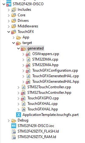

I have installed the new Touch GFX 4.17.
Created a blank project for F429_disco
Open CubeIDE, create new project from existing IOC file, but can't compile the project.
0693W00000BcdirQAB.jpgIs it the right way to do it ?
Tanks for your help.
/BR
When you create a project from TouchGFX Designer with the TouchGFX Board Setup (new name for Application Template) for the STM32F429 disco board and generate code from TouchGFX Designer, a fully configured STM32CubeIDE project will be generated for you. To open it you just have to double click on the .cproject or .project under the <project name>/STM32CubeIDE folder (no need to use the "create new project from existing IOC file" option).

thanks, it works fine.
After, is it possible to import IOC file to make modification on the components use on the board ?
/BR
Laurent
In the project generated you already have an ioc file as well which you can modify. Otherwise yes it is fine to import IOC file but you just have to make sure to correct all the paths.
