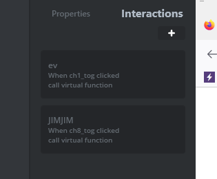

I have been days traying to create an event  from a custom container with a toggle switch
under the container I have created an event for a toggle button
I have called the container panel which holds the toggle button and event
under generated gui I see the generated event handler
I then want to copy that event handler in to panel.cpp and create a new event for a custom container

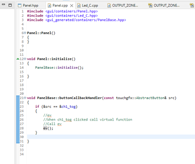

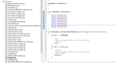

this is the generated code
when i try to add this to add this to panel.cpp     (the custom container, just compiler errors ???
void PanelBase::buttonCallbackHandler(const touchgfx::AbstractButton& src)
if (&src== &ch1_tog)
//ev
//When ch1_tog clicked call virtual function
//Call ev
ev();
if (&src== &ch8_tog)
//JIMJIM
//When ch8_tog clicked call virtual function
//Call JIMJIM
JIMJIM();

if I only try one event like below....
//ev
//Call ev
ev();
i still get errors ???
15:03:55 **** Incremental Build of configuration Debug for project Riverdi_70STM32H7_CM7 ****
make -j8 all
arm-none-eabi-g++ "C:/TouchGFXProjects/Train/CM7/TouchGFX/gui/src/containers/Panel.cpp" -mcpu=cortex-m7 -std=gnu++14 -g3 -DDEBUG -DCORE_CM7 -DUSE_HAL_DRIVER -DSTM32H747xx -c -I../../../CM7/Core/Inc -I../../../CM7/FATFS/Target -I../../../CM7/FATFS/App -I../../../CM7/TouchGFX/App -I../../../CM7/TouchGFX/target/generated -I../../../CM7/TouchGFX/target -I../../../Drivers/STM32H7xx_HAL_Driver/Inc -I../../../Drivers/STM32H7xx_HAL_Driver/Inc/Legacy -I../../../Utilities/JPEG -I../../../Middlewares/Third_Party/FatFs/src -I../../../Middlewares/Third_Party/FreeRTOS/Source/include -I../../../Middlewares/Third_Party/FreeRTOS/Source/CMSIS_RTOS_V2 -I../../../Middlewares/Third_Party/FreeRTOS/Source/portable/GCC/ARM_CM4F -I../../../Drivers/CMSIS/Device/ST/STM32H7xx/Include -I../../../Drivers/CMSIS/Include -I../../CM7/../../CM7/Middlewares/ST/touchgfx/framework/include -I../../CM7/../../CM7/TouchGFX/generated/fonts/include -I../../CM7/../../CM7/TouchGFX/generated/gui_generated/include -I../../CM7/../../CM7/TouchGFX/generated/images/include -I../../CM7/../../CM7/TouchGFX/generated/texts/include -I../../CM7/../../CM7/TouchGFX/generated/videos/include -I../../CM7/../../CM7/TouchGFX/gui/include -I../../../CM7/USB_HOST/App -I../../../CM7/USB_HOST/Target -I../../../Middlewares/ST/STM32_USB_Host_Library/Core/Inc -I../../../Middlewares/ST/STM32_USB_Host_Library/Class/MSC/Inc -O0 -ffunction-sections -fdata-sections -fno-exceptions -fno-rtti -fno-use-cxa-atexit -Wall -femit-class-debug-always -fstack-usage -fcyclomatic-complexity -MMD -MP -MF"Application/User/gui/Panel.d" -MT"Application/User/gui/Panel.o" --specs=nano.specs -mfpu=fpv5-d16 -mfloat-abi=hard -mthumb -o "Application/User/gui/Panel.o"
arm-none-eabi-g++ -o "Riverdi_70STM32H7_CM7.elf" @"objects.list" -l:libtouchgfx-float-abi-hard.a -mcpu=cortex-m7 -T"C:\TouchGFXProjects\Train\STM32CubeIDE\CM7\STM32H747XIHX_FLASH.ld" --specs=nosys.specs -Wl,-Map="Riverdi_70STM32H7_CM7.map" -Wl,--gc-sections -static -L../../CM7/../../CM7/Middlewares/ST/touchgfx/lib/core/cortex_m7/gcc -LC:/TouchGFXProjects/70STM32H7_v4_Copy/CM7/Middlewares/ST/touchgfx/lib/core/cortex_m7/gcc -LE:/TouchGFX/4.22.0/designer/Riverdi_70STM32H7/CM7/Middlewares/ST/touchgfx/lib/core/cortex_m7/gcc -LC:/TouchGFXProjects/MyApplication_56/CM7/Middlewares/ST/touchgfx/lib/core/cortex_m7/gcc -LC:/TouchGFXProjects/Train/CM7/Middlewares/ST/touchgfx/lib/core/cortex_m7/gcc --specs=nano.specs -mfpu=fpv5-d16 -mfloat-abi=hard -mthumb -Wl,--start-group -lc -lm -lstdc++ -lsupc++ -Wl,--end-group
C:/ST/STM32CubeIDE_1.13.0/STM32CubeIDE/plugins/com.st.stm32cube.ide.mcu.externaltools.gnu-tools-for-stm32.11.3.rel1.win32_1.1.0.202305231506/tools/bin/../lib/gcc/arm-none-eabi/11.3.1/../../../../arm-none-eabi/bin/ld.exe: ./Application/User/gui/Panel.o: in function `PanelBase::buttonCallbackHandler(touchgfx::AbstractButton const&)':
C:/TouchGFXProjects/Train/CM7/TouchGFX/gui/src/containers/Panel.cpp:22: multiple definition of `PanelBase::buttonCallbackHandler(touchgfx::AbstractButton const&)'; ./Application/User/generated/PanelBase.o:C:/TouchGFXProjects/Train/CM7/TouchGFX/generated/gui_generated/src/containers/PanelBase.cpp:296: first defined here
collect2.exe: error: ld returned 1 exit status
make[1]: *** [makefile:100: Riverdi_70STM32H7_CM7.elf] Error 1
make: *** [makefile:93: all] Error 2
"make -j8 all" terminated with exit code 2. Build might be incomplete.
15:04:00 Build Failed. 4 errors, 0 warnings. (took 5s.186ms)

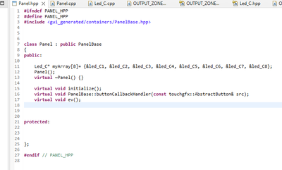

from ../../CM7/../../CM7/TouchGFX/gui/include/gui/output_zone1_screen/OUTPUT_ZONE1View.hpp:4,
from C:/TouchGFXProjects/Train/CM7/TouchGFX/gui/src/output_zone1_screen/OUTPUT_ZONE1View.cpp:1:
../../CM7/../../CM7/TouchGFX/gui/include/gui/containers/Panel.hpp:16:18: error: cannot declare member function 'PanelBase::buttonCallbackHandler' within 'Panel'
16 | virtual void PanelBase::buttonCallbackHandler(const touchgfx::AbstractButton& src);
In file included from ../../CM7/../../CM7/TouchGFX/generated/gui_generated/include/gui_generated/output_zone1_screen/OUTPUT_ZONE1ViewBase.hpp:12,
from C:/TouchGFXProjects/Train/CM7/TouchGFX/gui/src/output_zone1_screen/OUTPUT_ZONE1Presenter.cpp:1:
In file included from C:/TouchGFXProjects/Train/CM7/TouchGFX/gui/src/containers/Panel.cpp:1:
make[1]: *** [Application/User/gui/subdir.mk:47: Application/User/gui/OUTPUT_ZONE1View.o] Error 1
make[1]: *** Waiting for unfinished jobs....
make[1]: *** [Application/User/gui/subdir.mk:49: Application/User/gui/Panel.o] Error 1
make[1]: *** [Application/User/gui/subdir.mk:45: Application/User/gui/OUTPUT_ZONE1Presenter.o] Error 1
from C:/TouchGFXProjects/Train/CM7/TouchGFX/generated/gui_generated/src/output_zone1_screen/OUTPUT_ZONE1ViewBase.cpp:4:
from ../../CM7/../../CM7/TouchGFX/generated/gui_generated/include/gui_generated/common/FrontendHeapBase.hpp:15,
from ../../CM7/../../CM7/TouchGFX/gui/include/gui/common/FrontendHeap.hpp:4,
from C:/TouchGFXProjects/Train/CM7/TouchGFX/generated/gui_generated/src/common/FrontendApplicationBase.cpp:6:
make[1]: *** [Application/User/generated/subdir.mk:163: Application/User/generated/OUTPUT_ZONE1ViewBase.o] Error 1
make[1]: *** [Application/User/generated/subdir.mk:145: Application/User/generated/FrontendApplicationBase.o] Error 1
from C:/TouchGFXProjects/Train/CM7/TouchGFX/target/generated/TouchGFXConfiguration.cpp:21:
from C:/TouchGFXProjects/Train/CM7/TouchGFX/target/generated/TouchGFXGeneratedHAL.cpp:21:
make[1]: *** [Application/User/TouchGFX/target/generated/subdir.mk:44: Application/User/TouchGFX/target/generated/TouchGFXConfiguration.o] Error 1
make[1]: *** [Application/User/TouchGFX/target/generated/subdir.mk:46: Application/User/TouchGFX/target/generated/TouchGFXGeneratedHAL.o] Error 1
15:56:26 Build Failed. 16 errors, 0 warnings. (took 4s.17ms)

Then why you place PanelBase into other class and ask why compiler say error.?
