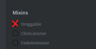

If possible, please tell me one more thing about the swipe function. When you open the home screen of the iPhone, you can move the arrangement of the icons freely by pressing and holding the icon. Is it possible to achieve this same operation with buttons in TouchGFX?

Yes it's possible to move elements. In TouchGFX if you enable the "Draggable" mixin, you'll be able to move elements.

Thank you for your answer regarding vertical swipe and drag, @Osman SOYKURT .
I was able to resolve many questions.
I'm looking forward to the vertical swipe update.
