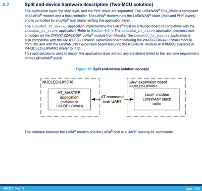

I recently came across an ST article describing a Condition-Based Monitoring architecture using a dual-MCU approach, with an STM32L476RG handling signal processing (and potentially edge AI), and an STM32WL dedicated to network connectivity.
I find this architecture very interesting and relevant for a project I’m currently exploring, but I would like to better understand what level of support and resources are available from ST for implementing such a solution in practice.

There aren't really any special resources or support necessary - just treat it as two separate microcontroller projects.
Most likely, they will just communicate via one simple interface; eg, UART.
An example would be the LoRa projects which implement an AT-command interface
https://www.st.com/resource/en/user_manual/um2073-stm32-lorawan-expansion-package-for-stm32cube-stmicroelectronics.pdf#page=37
via: https://www.st.com/en/embedded-software/i-cube-lrwan.html#documentation

For STM32WL you can consider the  AN5554 while for STM32L4 you need to consider either to implement a custom bootloader or simply use the ST bootloader (AN2606) most probably using the UART interface and make STM32WL a bridge between the wireless server and STM32L4. Indeed you need to implement a mechanism that makes each of STM32WL and STM32L4 knows that the other MCU is going to be updated and synchronize with it.
