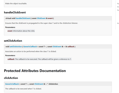

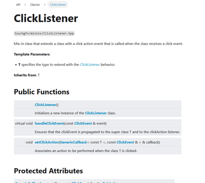

‎2023-09-19 1:12 AM
this type of page is so unhelpful ???
There should be 5 or 6 examples at the bottom showing how the click listner works ????/
the pages really mean nothing to me, very dificult to understand and no help at all >???
