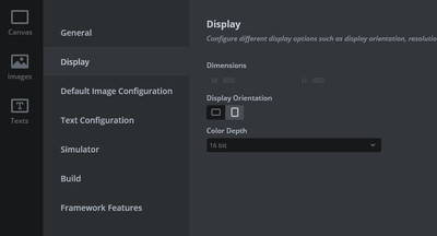

My project is using an alientek 4.3 inch TFTLCD screen, which is driven by FMC (Flexible Memory Controller).
And  ,The display effect of the button control does not meet my expectations after I load it.“next text”is my button,
that there are many horizontal dots or speckles inside。
thank you

Hello @zhaowhong ,
Did you change the orientation of your screen in TouchGFX? Have you applied layout rotation on your image?
Osman SOYKURT
zhaowhong
thank you
 "I have not added any image."Is this related to not adding anything?" I found  if I select
 The display effect is well.
stm32F767
