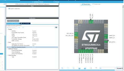

Hi everyone, after I've configured TouchGFX, the program needs to be manually run in Keil's debug environment to execute. Why is that?
My ICNA3306_DrawBlock data transfer did not use DMA.

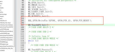

Hi,Gaetan Godart.My ICNA3306() is fine and can be used without running touchgfx. I removed ICNA3306 Init() and added the light LED, but the LED did not light up. You can try to delete ICNA3306 and see if you can run the program.
I can confirm that the PIN13 IO pin is normal, and I can light up without using touchgfx.

Hi,Andrew Neil,This screenshot shows my TouchGFX configuration. Sigh, I really don't know how to solve this. I removed my display initialization function and instead tried to turn on the LED before initializing TouchGFX — unfortunately, it still doesn't work. In a project without TouchGFX, the LED lights up just fine.
For custom hardware, I might look at the initial state of the BOOT0 pin, and that the Vector Table is correctly initialized.
Check VCAP capacitances and voltages.
When debugging the debugger may initializes GPIO and clocks to suit it's needs, whereas booting directly will not. Watch also that timings can be a little different with the debugger involved, so if stuck in while() loops identify what's being waited on, or if they exit early. Use volatile variables where appropriate.
