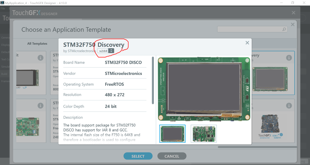

2020-04-12 11:23 PM
Hello Martin,
Thank you very much to the solution to the question.
It worked fine as you suggested
after modifying it in the config Tab.
But what does "V3" mean in Application Template?
(TouchGFX 4.13.0)
Would you let me know it ?
