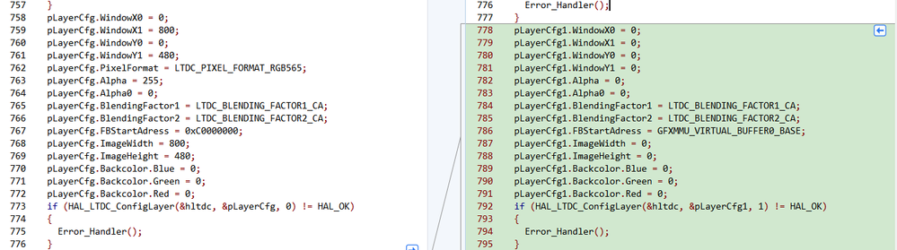

For example, I am also running Stm32CubeIDE 1.4.2. When doing a CubeMX Generate, I am now getting the following error that I never had before:
/Core/Src/main.c:786:30: error: 'GFXMMU_VIRTUAL_BUFFER0_BASE' undeclared (first use in this function)
It is failing on the assigning of pLayerCfg1.FBStartAdress in the following lines of code...which didn't exit prior to this new install of CubeIDE and TouchGFX:
pLayerCfg1.WindowX0 = 0;
  pLayerCfg1.WindowX1 = 0;
  pLayerCfg1.WindowY0 = 0;
  pLayerCfg1.WindowY1 = 0;
  pLayerCfg1.Alpha = 0;
  pLayerCfg1.Alpha0 = 0;
  pLayerCfg1.BlendingFactor1 = LTDC_BLENDING_FACTOR1_CA;
  pLayerCfg1.BlendingFactor2 = LTDC_BLENDING_FACTOR2_CA;
  pLayerCfg1.FBStartAdress = GFXMMU_VIRTUAL_BUFFER0_BASE;
  pLayerCfg1.ImageWidth = 0;
  pLayerCfg1.ImageHeight = 0;
  pLayerCfg1.Backcolor.Blue = 0;
  pLayerCfg1.Backcolor.Green = 0;
  pLayerCfg1.Backcolor.Red = 0;
  if (HAL_LTDC_ConfigLayer(&hltdc, &pLayerCfg1, 1) != HAL_OK)
    Error_Handler();

Like I said, I was previously using Stm32CubeIDE 1.3.1 and TouchGFX 4.130. After using Stm32CubeIDE 1.4.2 and TouchGFX 4.14.0, this whole section was added to MX_LTDC_Init(), as seen in the difference below:
This is a bug from CubeMX that was reported and will be fixed for the next version of CubeMX (6.1 if I recall correctly).
CubeMX add the second layer even though you don't want it which makes the project not work anymore.
To fix it you have two solutions :
  • In CubeMX you can add manually the second layer and set everything to 0, especially the FB Start Address because this is the part that impacts the application.
  • Or you can add/replace the files in the enclosed archive to the folder C:\Program Files\STMicroelectronics\STM32Cube\STM32CubeMX_6_0_1\db\mcu\IP
