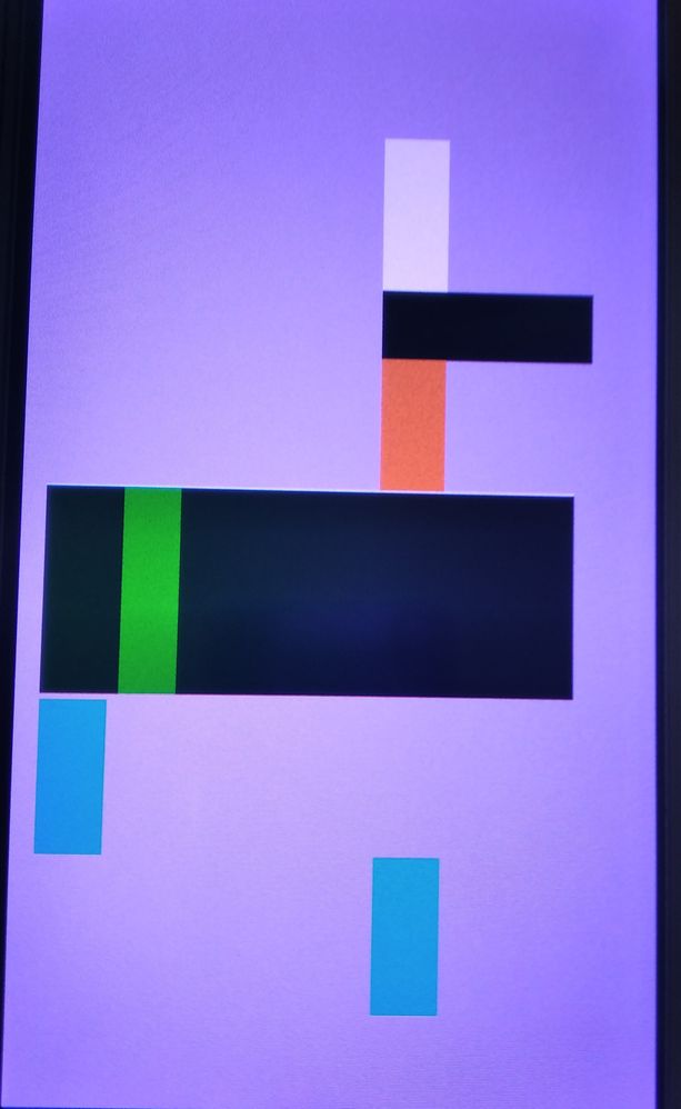

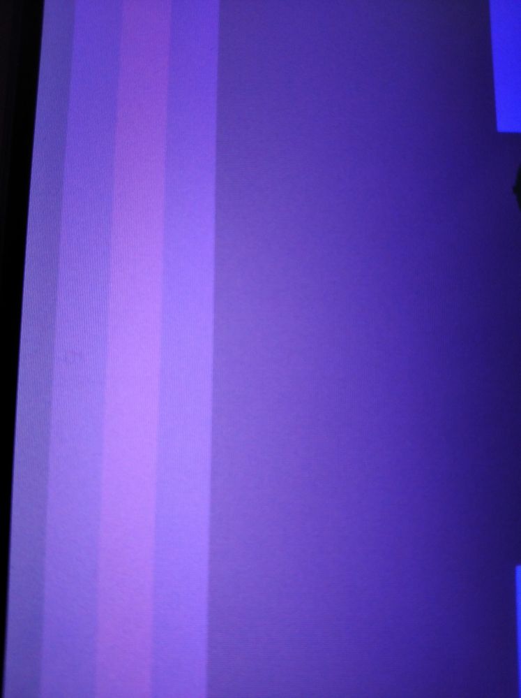

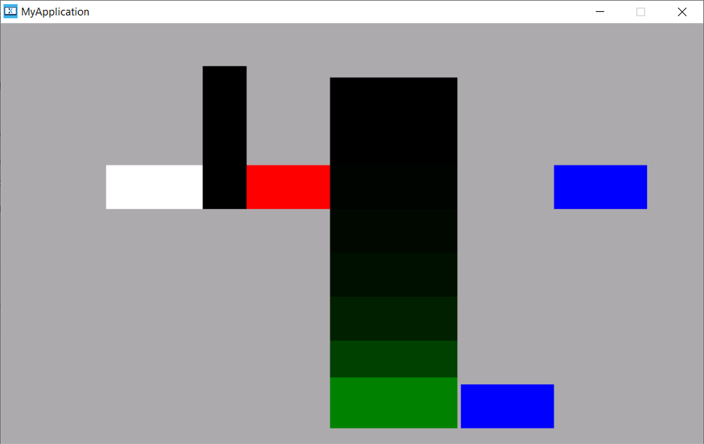

I am currently trying to display color properly on an RGB panel with parallel interface. However, colors are not displaying properly and I currently do not know what else to troubleshoot. I am using STM32F769I eval board connected to the RGB panel.
I have initialized the 8MB SDRAM where I am allocating one single frame buffer 800x480*3 forTouchGFX. I have verified that I am able to read and write correctly to the SDRAM.
However, when I set:
  • LTCD/Display Type to RGB888
  • Frame buffers to RGB888
White vertical lines appear on the panel and the SDRAM memory seems to have incorreclty placed 0xFF values.
If I change the configuration to:
  • LTCD/Display Type to RGB565
  • Frame buffers to RGB565
The result is that the LTCD panel has no noise but colors are incorrect. The SDRAM memory correctly stores the frame buffer colors but the color displayed is not correct. In touchGFX I define a grey color with values 0xAAAAAA which is correctly translated into RGB565 0x55AD but is displayed as purple (green component seems incorrect).
Changing the LTCD/Display Type to RGB888 but leaving frame buffers as RGB565 has the same effect as using LTCD/Display Type RGB565.
Here are the results of the test setups explained:
Target image result
0693W00000KZxyUQAT.pngRGB888
0693W00000KZxzSQAT.jpgRGB5650693W00000KZxvdQAD.jpgAny guidance regarding possible causes will be greatly appreciated.

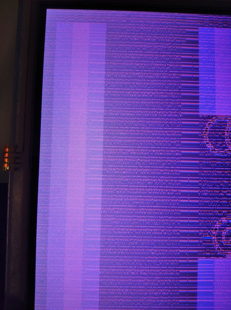

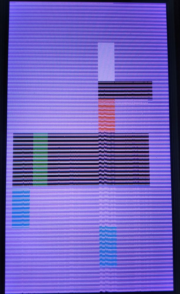

This results in some places haveing random white values. Changing the framebuffer pixel format to ARGB8888 solves the problem but the frame buffer is much larger than expected I might not be undersanting something about how does touchGFX handles the frame buffers but as far as I understand once the LTCD panel is configured correctly changing the frame-buffer should not affect the result.
Random white nose that can be seen
0693W00000Ka7MLQAZ.jpgCorrect image once ARGB8888
MM..1
Chief III
Here is hard reply, but first testing you need do without TouchGFX.
TGFX is only library to manage framebuffer in memory. Transfer image to LCD isnt primary job, and all code for manage this is in target folder .
From your image seems trouble maybe is in horizontal HSYNC PORCHs values .
RGB888 vs ARGB8888 is only in MCU conversion , into LCD everytime go RGB888 mode set for LTDC out.
For testing you in code comment out start RTOS and before main while place some for memsets in framebuffer memory create test patterns colours,,,

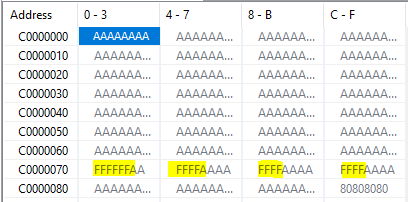

It looks like there is an error when filling the SDRAM memory. The frame buffer, if correctly filled is displayed, correctly. I did disable the TouchGFX task and tested some patterns with memset. The results where quite surprising.
If I set all memmory in one mem set the values are stored incorrectly while if i set in a 32bits steps it is correctly stored.
/* First part which correctly fills the memmory */f
for(counter = 0 ; counter< 20; counter ++ ){
      memset(0xC0000000 +4*counter, 0xAAAAAAAA, 4);
 /* Second part of the memmory fill which is filled incorrectly*/
memset(0xC0000000 + 4*20, 0xAAAAAAAA, 60);
Memmory values after execution
MM..1
Chief III
Seems your sdram clock config or hardware wires have some trouble.
Try memset with bytes no words.
You on eval board then i mean hardware issue less possible, check sdram init.
