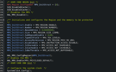

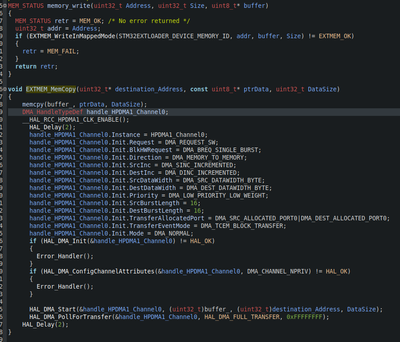

I'm trying to create an external loader for my stm32h7s7-dk board via MCE.
I followed this https://www.youtube.com/watch?v=JxhKmVUB2Ws&list=PLnMKNibPkDnFQXYK0ztHV9iMVS6EAtKpD&index=10 tutorial series and i check the github repo of this project. But the repo and the video series can be different. The instructor might add some new things. But the methodlogy cant work. Its really stupidly.

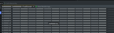

The loader writes only 0x00 to flash for app size.
Im adding my ss of the mem_copy, mem_write and mpu init codes here.
  Please help me.

same issue @neset i was able to make mce works in cube h7rs v1.2.0 but in 1.3.0 the verification of the flash after downloading gives 0x00
