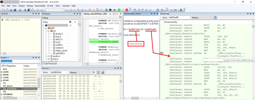

Using any type of text causes HardFault
HMehr.14
I followed this guide (https://touchgfx.zendesk.com/hc/en-us/articles/115002741432-Create-custom-Application-Template) to adding TouchGFX to my existing project.
I'm working with IAR 8.30.1 and tgfx 4.10.0 and STM32F429ZG and FreeRTOS V9.0.0 ( with `heap_4.c` as memory manager ).
Everything works well now, except texts. Every time I added components that contain text, Hard Fault occurs during redraw (*.invalidate()) it.
I added
virtual void handleTickEvent() { container.invalidate(); }
to my ScreenView class to verifying DMA2D and LTDC configurations. All components work well. But existing just a text component causes HardFault.
By tracking `LR` and `PC`, I find out that HardFault occures in `TextProvider` class.
I think stack corrupted. Due to often times, `PC` is in the `DataSection`.
I increased the stack size of my GUI task and `configTOTAL_HEAP_SIZE` of FreeRTOS configuration, But results not changed. Is there any other stack size ( or heap size ) limitation?
Or, May I has been configured `BoardConfiguration.cpp`, `STM32F4DMA.cpp` or `STM32F4HAL.cpp` in a wrong way ?
For more details :
Please share your suggestions about my problem with me.
Thanks in advance.

Hi, I have a similar problem. Any text added to TouchGFX designer causes the application to HardFault. Setting the Wildcard characters doesn't fix the issue.
This has not been a problem before, but after messing with wildcard fonts in designer I cannot revert to the before state. Even reverting the .touchgfx file to the state when it was working does not fix the issue.
If I remove text from Designer everything works. Is this a bug known by ST? Is there a fix ?
Thanks,
Tytus
 edit: same thing after upgrading to touchgfx designer 4.15 (in cubemx too).

Compiling the code through the TouchGFX Designer instead of cubeIDE fixed the issue for me.
There seems to be a problem with text and bitmaps when put to external flash if generated with cubeIDE - fonts give HardFault and bitmaps are not displayed correctly. This is not a case when only internal flash is used.
Hope this bug will be fixed.
