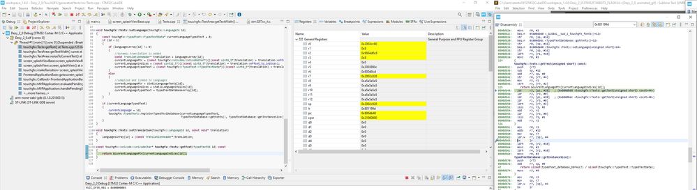

‎2021-01-27 4:14 AM
Hi Tesla,
I did find that returning from the function
touchgfx::Unicode::UnicodeChar* touchgfx::Texts::getText(TypedTextId id)
inside Touchgfx/generated/texts/src/Texts.cpp
jump to an odd flash memory address, I don't know if that can be the cause, but before that call all the disassembly steps goes right into pair address.
after that call an instruction "bx lr" jump to an odd address due to the fact that inside the LR register there is an odd address.
The address range is correct and pointing to the right back function .
At the same time the debugger became instable and is more and more difficult to proceed stepping the code.
If left run, the code goes suddenly into an hardfault.
All the function used are from library and/or auto generated code, so it's very strange.
All the text pointer into the external memory seems corrects. I can see the offsett of every string I'm using.
I think to a wrong aligned code but how it can be verifyed ? since the code is precompiled?
thanks.

‎2021-01-28 9:53 AM
Ok, Today I did realized an external loader to speed up the debug and during this activity I learn more about the quadspi.
The problem related to the text was a false problem , because the lcd did shows the last correct image, so I thought that the images did run and the texts fails, but I was wrong.
The problem involve all the graphic rendering when I try to us ean external memory.
So I have:
- a freeRTOS running with a single task ( the touchgfx task) priority normal, stack = 8192byte,
- LCD initialization tested with a fixed static (in flash) image and with a fixed static in 0x90000000 (quadspi address)
- Quadspi running ( after the MemoryMappedMode activation, on debug I can see all the data stored with my external loader)
- FMC running ( after the SDRAM init I can see the all the data passing from 00000 to garbage )
I create a simple project with touchgfx designer and with all the data on internal flash all goes well, ( gif, text, animation and fade-in process etc..)
When I move something into quadspi memory nothing is showed on the screen, it call all the initialization function into the file ViewBase.cpp and then it became un-debuggable.
I try to change the priority of all the IRQ involved ( ) but nothing.
I tryed to check if the quadspi is readable putting a raw image on it and configuring the framebuffer to pointing to, and it works.
Can You help me to find a way ?
Thank you.
