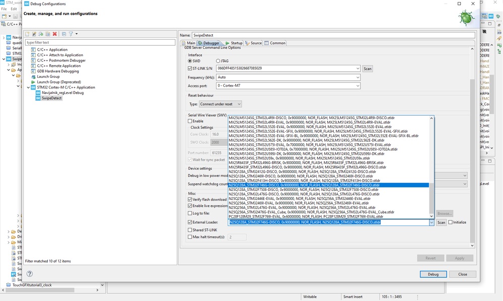

Hi, had a same problem, took me hours to fix it. The reason is that some content (image and text is to be placed on external flash). To load onto external flash you need an external loader. CubeIDE, CubeProgrammer or Keil uVision are neither aware of that and you need to set it up manually, while TouchGFX Designer is apparently correctly setup to use external loader.
Keil uVision: Project Options -> Debug -> Use: ST-Link debugger -> settings -> flash download -> ADD -> find flash loader for your evaluation board or create your own loader -> set RAM size to 0x00050000, leave RAM adress unchanged.STM32CubeIDE:
Debug Configurations -> Debugger -> Scroll down and tick External loader -> Scan -> find appropriate loader for your eval board.
Similar procedure on Cube Programmer and other IDEs.

Good input, that makes sense. In the case of Touchgfx it is because it is set in the Makefile (gcc folder). We set them manually as well for all IDEs in the application templates in Designer.
It makes a lot of sense that we should make users aware that they need to setup the external loader, it is in some of ST's documentation but it is a real maze, so a reminder never hurts.
