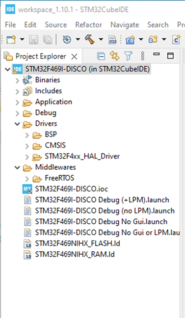

I was able to open my project in the new IDE and build it without errors. My original project explorer window looks like this:
You can see that there is a CMSIS folder, a STM32F4xx_HAL_Driver folder, and a Middlewares folder with FreeRTOS. Each of these folders contains linked files to the source.

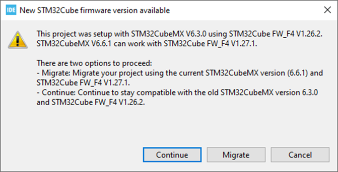

Next, I try to open the STM32F469I-DISCO.ioc file in CubeMX, and I am presented with the following dialog:
When I select Migrate, the process results in the loss of the previously mentioned folders, and I get this:
Now when I Generate Code in MX and then do a build, I get over 300 undefined references, most due to HAL_ calls. The missing folders were originally added automatically when I first created the project (I think - it's been a long time).
