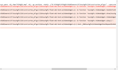

‎2024-08-06 2:17 AM
I have same issue.
I am using touchgfx 4.18.1 & cubeide 1.8.0
could anybody help on this?
