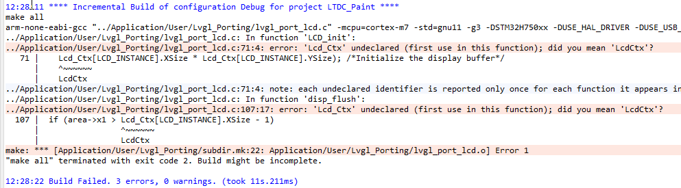

I am going crazy, I always get the error that the structure Lcd_Ctx is not declared, while it is clearly declared (by including "stm32h750b_discovery_lcd.h").
With F3 I can find the structure declaration.
If I change the file from .c to .cpp the error is gone...
See screenshot below:

In the 745 h-file the variable is declared with extern Lcd_Ctx, and in the 750 h-file with LcdCtx ...

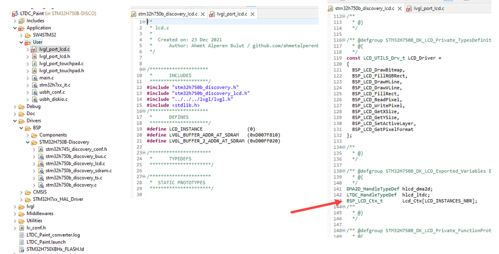

Sorry , but you dont show where you declare Lcd_Ctx not type , but object. Try show code part.
pk84
pk84Author
October 20, 2022
here:
Bob S
October 20, 2022
There should be a .h file with an "extern" declaration for that variable (maybe in stm32h750b_discovery_lcd.h). Make sure that you include that file in your lvgl_port_lcd.c file. If there isn't an "extern" declaration somewhere, you need to add one.
pk84
pk84Author
October 21, 2022
In following code there is no "extern" declaration, see link/screenshot below.
I just copied the files into my code, and if possible I don't want change something in these files.
Why do I need it in my code this "extern" but in the mentioned/linked code there is no "extern" declaration? How can I do it the same way?

Hello, I think that it finds your structure but not your variable, in the file where you want to use your variable you must write extern BSP_LCD_Ctx_t Lcd_Ctx[LCD_INSTANCES_NBR] because the variable is not declare in the same file.

I think it's in stm32h745i_discovery_lcd.h, line 234: "extern BSP_LCD_Ctx_t Lcd_Ctx[];"
then he calls his .h in his .c file
