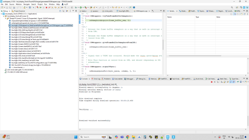

When we started inputting texts in TouchGFX the system would wait infinitely in xQueueSemaphoreTake() function so we suspected something might be wrong with loading from external flash so we created another project this time stored everything in internal flash, again the result was same, the TouchGFX hangs while using texts.

‎2025-01-14 12:48 AM
Hi.
The issue about MPU in the topic you refer to is to disable prefetching outside of the QSPI range.
This is important and should be done. Normally this gives an error after running a while (could be hours).
Try moving texts and fonts to internal flash for a test. This is done in the linker script.
Also check the DMA2D for errors. One error is the configuration error. There is maybe a handler for this in the top of TouchGFXGeneratedHAL.
It can also be a DMA2D Transfer error. This comes if there is a error on the memory subsystem during the transfers.
You can check this by looking at the DMA2D registers (in the ISR register).
If you get this, you do not get the Transfer Complete interrupt, and the process stops.
