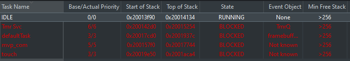

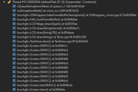

When switching between screens fast, my UI always ends up freezing. Debugging reveals that it waits forever, waiting for the frame buffer semaphore.
Here is the call stack:
Inspecting other running tasks shows nothing wrong. Only the graphics task should touch the frame buffer semaphore, right? So it should never deadlock?

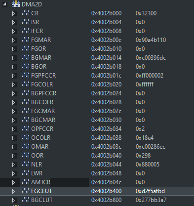

Once stuck :
Here's the DMA2D registers :

‎2021-06-08 12:37 AM
Just an update for everyone following the thread:
From the stack trace it is clear that touchgfx gets stuck while drawing a series of glyphs. This is something we've fixed in more recent versions of TouchGFX. I'm following this avenue of thought with OP by email.

‎2021-06-21 12:44 AM
Which version are you using? There was a bug, once, but we're talking way back, where lockFrameBuffer() would cause a deadlock if a glyph was the last thing to be transferred by DMA2D.
