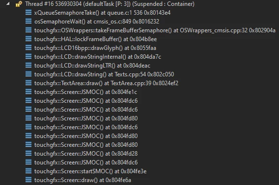

When switching between screens fast, my UI always ends up freezing. Debugging reveals that it waits forever, waiting for the frame buffer semaphore.
Here is the call stack:
Inspecting other running tasks shows nothing wrong. Only the graphics task should touch the frame buffer semaphore, right? So it should never deadlock?

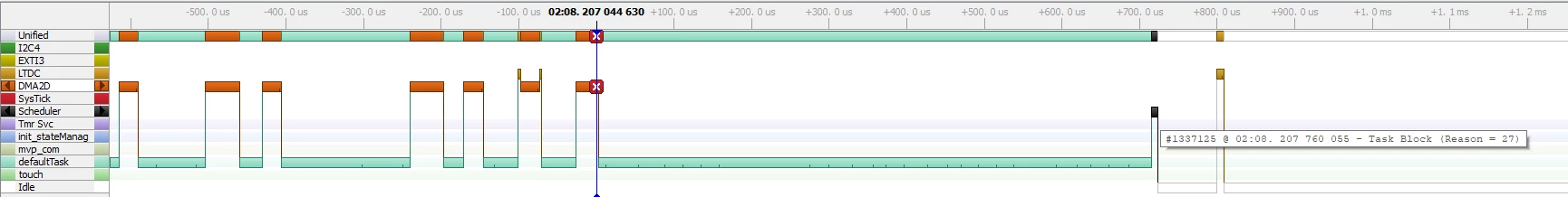

So, after adding systemview to the project, I can have a better view of what's happening. I disabled most interrupt and most of the tasks that were not needed for the device to work. All ISR are instrumented (except Systick so I can record all the other events without overflow). I also added an error message when there is an error release the semaphore :
In the SystemView data, to find the moment it hanged, go to the last error releasing.
As is, we have a crash every minute when switching screens quickly. Here's the initial SystemView file : https://foobot-my.sharepoint.com/:u:/g/personal/tony_foobot_io/EXZrj5YAW7lKowqbPLSE11IB3d6v07Os2ase-T4dj3PpQA?e=Dkqtat

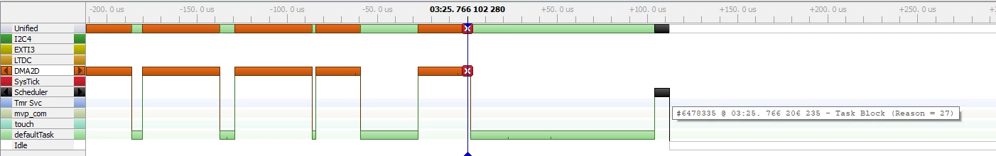

We can see that it tried to release the mutex twice, as it defaultTask (the touchgfx task) is not taking it between the two interrupts.
It happens before without any problem, so it shouldn't be the root cause of the issue.
So there is DMA2D releasing it, defaultTask trying to take it without success apparently. DMA2D interrupt are not fired anymore, probably because GUI task is stuck ? or GUI stuck because DMA2D interrupt are not fired anymore ? Hard to answer ...
Then we can see the DMA2D interrupt is fired and process in the middle of LTDC interrupt. It's the only time that we have release mutex twice and DMA2D during LTDC interrupt. LTDC interrupt had prio 9 and DMA2D 5, so it might be the culprit ?
I changed LTDC prio to 5 & DMA2D to 6. It improves the situation as it takes 20-30 min to hang, but it doesn't disappear. SystemView file here : https://foobot-my.sharepoint.com/:u:/g/personal/tony_foobot_io/EUOXkdB9JnpPjurLLI5dpkUBIsh4uaTuf6C5E2xeALu9Tw?e=F4FYOB
0693W000008ycOmQAI.pngSo now, we can see the same behavior, except that no LTDC interrupt have been triggered during DMA2D interrupt, so it's not the root cause, but it improves the situation. We can also see that the only things happening at this moment, is DMA2D interrupt & defaultTask, so the external part of the system seems not to have an effect.

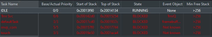

Can you check the actual status of the task? And the semaphore? There are plugins for some IDEs to do this. Switching screens quickly shouldn't have any impact except that the default task may try to take the semaphore while the DMA2D is busy with the framebuffer. And that should be fine - What isn't fine is if the DMA2D interrupt (when done) isn't releasing it.

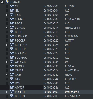

Once stuck :
0693W000008zFSsQAM.png0693W000008zFSdQAM.pngHere's the DMA2D registers :
