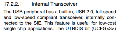

What can i take for a MCU which has function with Low Speed USB 1.1 ?
I must make a USB HID Interface as Gamecontroller.
It is essential to prevent the PC from getting stuck on the USB port, and this is only possible with USB 1.1.
greets

Hello @stefangem
the current range of STM32 products does not support USB 1.1 Low speed

AScha.3
USB low speed device ?
afaik no STM has it.
Ai tells: use a PIC18F2550 .
Yes only USB1.1. I already tried it with an STM32F103 in USB 2.0, but the computer hangs during boot. USB 1.1 works without any problems.
I wanted to avoid using a PIC microcontroller since I don't have a flasher and I don't know the programming language. I have an ISP flasher, an Atmel ICE, and an ST-Link.

It's a USB problem because USB 1.1 doesn't interfere with the BIOS. It's a USB joystick with two USB HID game controllers. The device has now a PIC MCU but is obsolete, and this doesn't interfere with the PC when the joystick is plugged in and powered on. I built a clone using the STM32F103 chip, but it's only running USB 2.0 full speed, and the PC won't start.
Windows recognizes it without any problems.
