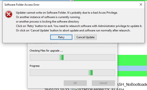

Hello Yoann,
From some reason the IOC file is fail to open successfully both from the IDE as well as from the CubeMX,
I get this0693W00000QKHpZQAX.pngAny idea?

Forget this Yoann,
Its look like I fail to upgrade CubeMX and this caused this error, I can run it OK now but regenerating the code did some major changes to my existing project so I'll abandoned this approach for now
