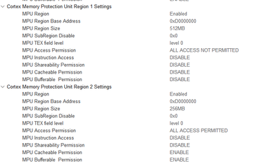

‎2024-04-22 11:18 AM - edited ‎2024-04-22 11:52 AM
That's great news, glad to be able to help you.
Please note that with MPU it is most likely possible to disable caching for just some memory area (framebuffer in this case (?)).
Br JTP
‎2024-04-23 12:34 AM
yes... this was my MPU set
