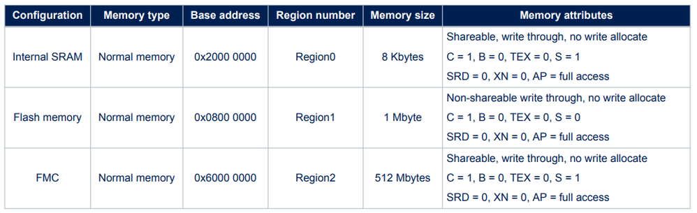

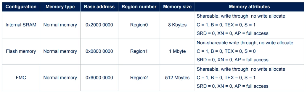

As an example configuration, we will define three MPU regions following the example provided in the application note as shown below:
Note: All the terms in this table are explained in the application note as well as all the definitions and explanations.

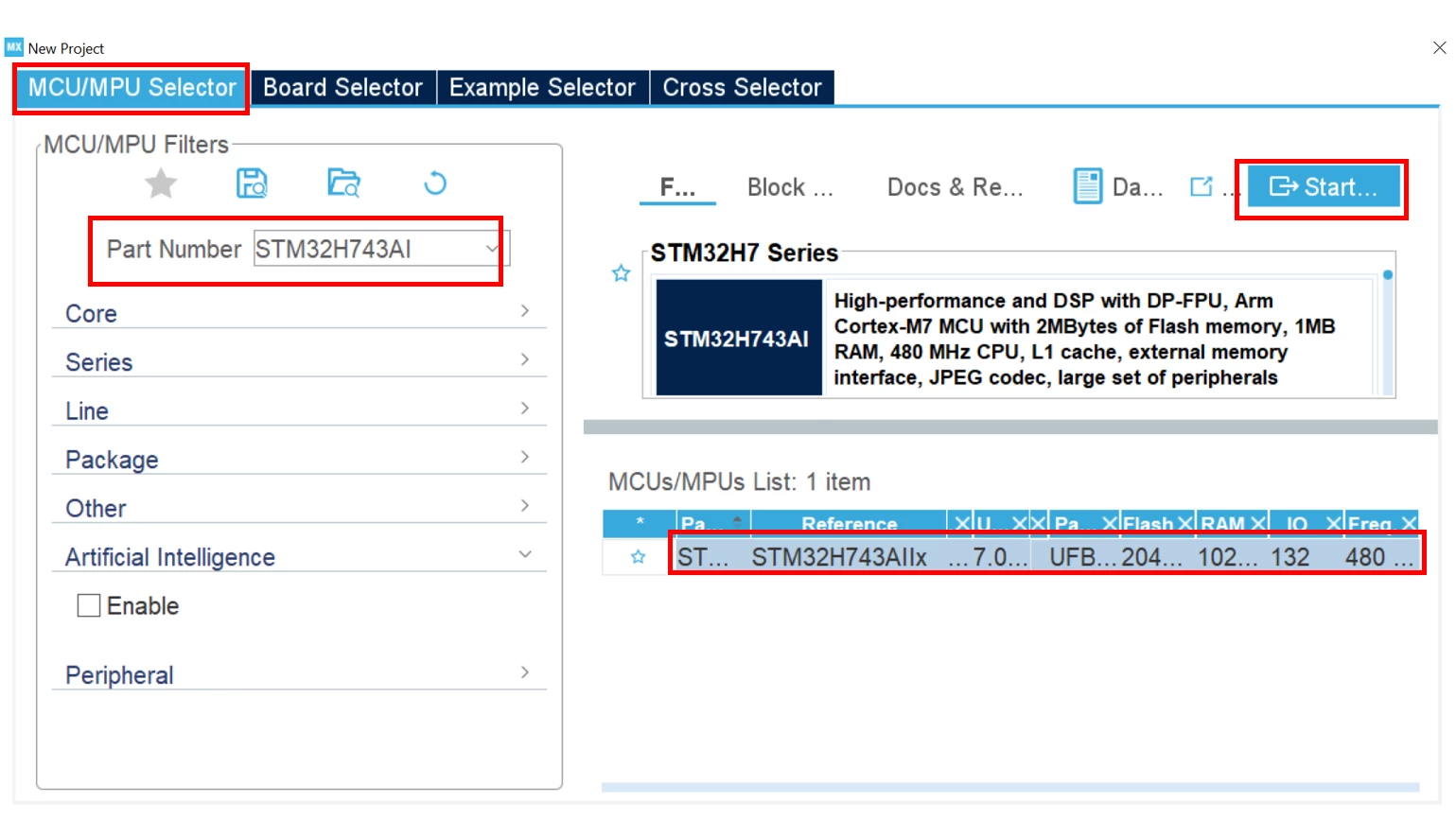

  1. Open STM32CubeMX
  2. Create a new project and select the STM32H743AI for this example

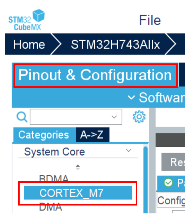

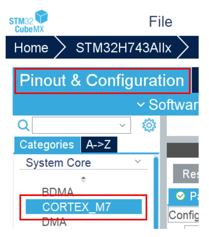

  • To gain access to the MPU settings, go to the Pinout & Configuration Tab and then click on Cortex-M7 as shown below:

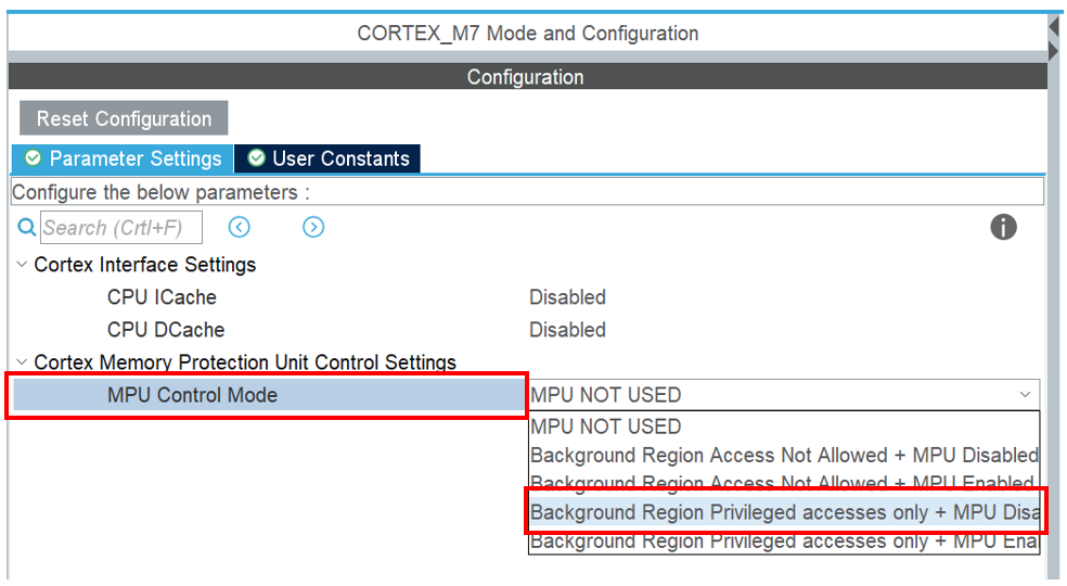

  1. Enable the MPU by selecting one of the four possible modes

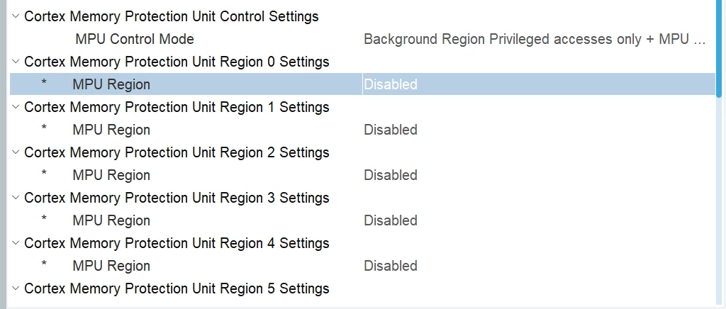

  1. Enable and configure the different MPU regions as show below:

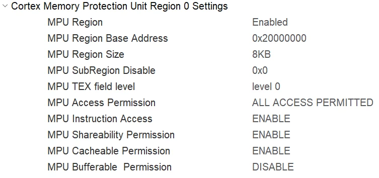

  1. Configure the three regions as defined in the table from the application note:
  1. Region 0 settings:
  • In STM32CubeMX, make the following selections:

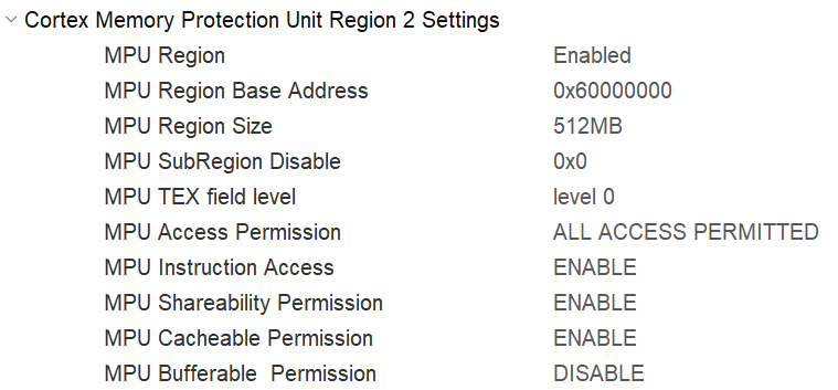

  1. Region 2 settings:
  • In STM32CubeMX, the configuration for this region should be set to:
The MPU configuration is now complete. While this article shows how to configure the MPU for the STM32H743AI following the example table in the application note, the MPU is highly configurable and can be tailored to variety of application needs.
