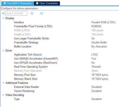

I'm using TouchGFX on a STM32U5G9 microcontroller and got stuck while trying to enable GPU2D (aka NeoChrom).
The starting and working configuration is TouchGFX + LTDC + DMA2D. Everything works properly: the signalVSync function of the OSWrappers is called periodically due to LTDC interrupts and so the counterpart waitForVSync.
As soon as I enable the GPU2D acceleration from CubeMX (following the guide here https://support.touchgfx.com/docs/development/touchgfx-hal-development/generator-how-to/touchgfx-al-configuration/driver), the screen remains black despite the signalVSync function is actually called. On the other hand the waitForVSync function is called 2 or 3 times and then no more.

Hi, yes, I get correct screen output only with LTDC + DMA2D. As soon as I enable GPU2D (in addition to LTDC and DMA2D), the screen goes black.

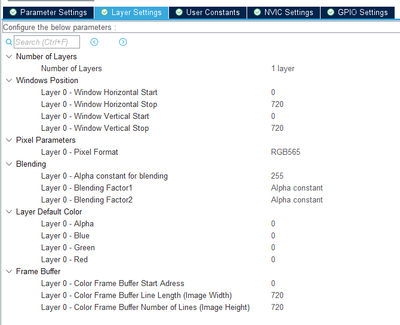

Screen size is 720 * 720 pixels and frame buffer strategy is "double buffer by allocation". The MCU I'm using is STM32U5G9 and has 3 MiB of RAM, so 2 MiB are dedicated to graphics.
The following is the working configuration for your convenience. To enable NeoChrom, I set the "Use GPU2D Accelerator" option from "No" to "Yes".

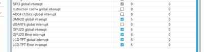

Make sure the GPU2D error interrupt is enabled as well, this is, somewhat counterintuitively, required for some operations.
I tried with no success. The following is my NVIC configuration
