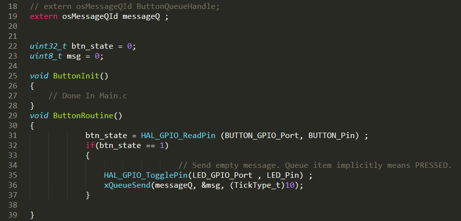

I am trying to do send/receive messages with Message Queues.
1) From TouchGFX Toggle Button to LED.
2) From Hardware Button to Text Area
as per below thread.
https://community.st.com/s/question/0D50X0000AU4zodSQB/interfacing-with-hardware-in-touchgfx-applications
Program Successfully Build . But Still not succeeded to Work on Actual Hardware.
LED is not OFF/ON with TouchGFX Toggle Button
2) From Hardware Button to Text Area Update
HardFault and/or MemManage_Handler
Because I have changed priorities and Heap .
 Can anybody look attachment ? Guide me What needs to be correct ?
To solve the problem .

The below code without TouchGFX Works well..
while(1)
	if ( HAL_GPIO_ReadPin (BUTTON_GPIO_Port, BUTTON_Pin) == GPIO_PIN_SET )
 		 HAL_GPIO_TogglePin(LED_GPIO_Port , LED_Pin) ;
        	 HAL_Delay(300) ;
		 printf("HELLO \r\n") ;

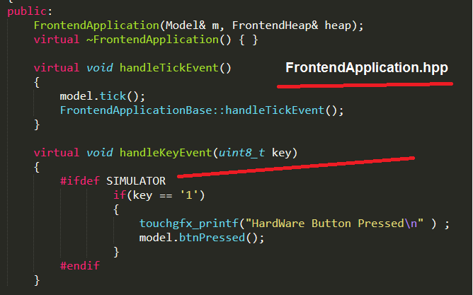

But Code worked on simulator Updating TextArea WildCard Perfectly ..

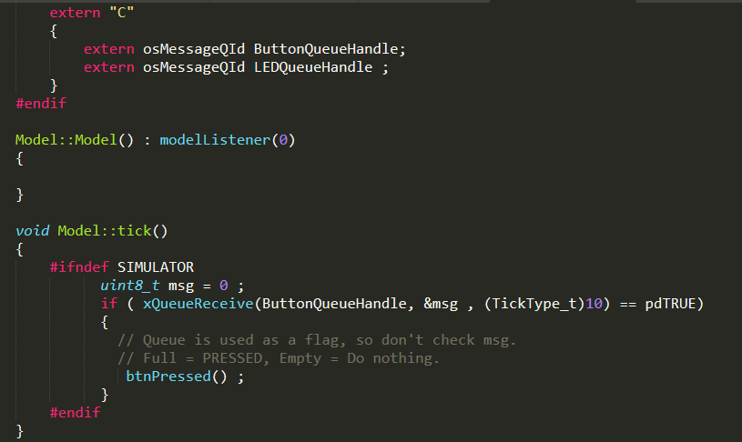

I have made some changes/correction in code attached at Msg #1.
After doing some experiments cause to Fault Situations.
 ( xQueueReceive(ButtonQueueHandle, &msg , (TickType_t)10) == pdTRUE)
Please Find updated files as works on simulator and touchgfx simulated short video..
as below method.. as per you webinar "Integratiing UI and Hardware"
Please Find attachment ..

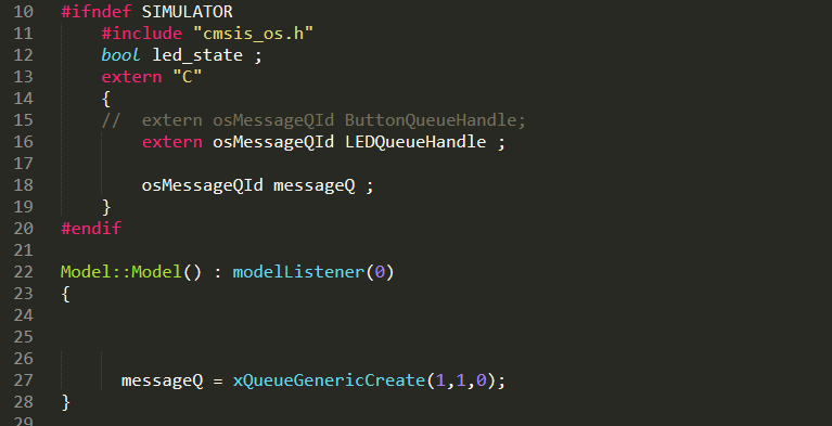

I think there is an error in your model.cpp
I'm referring to my own example in this video: https://www.youtube.com/watch?v=majcfxr3u2E
The model looks something like this:
extern "C"
	xQueueHandle messageQ;
Model::Model() : modelListener(0)
	messageQ = xQueueGenericCreate(1,1,0);
So I can see two things different in your setup:
  1. you have a osMessageQId instead of a xQueueHandle. I have no idea if they are actually the same type.
  2. in modelListener I create a queue and assign the handle to it. You don't have that call and that could be why the hardfault occurs?
Lastly you wait 10 ticks for your messages. I don't think that it is needed or it helps anything. I can't recall if the waiting is a blocking call or not. If it is you have reduced your framerate a bit.

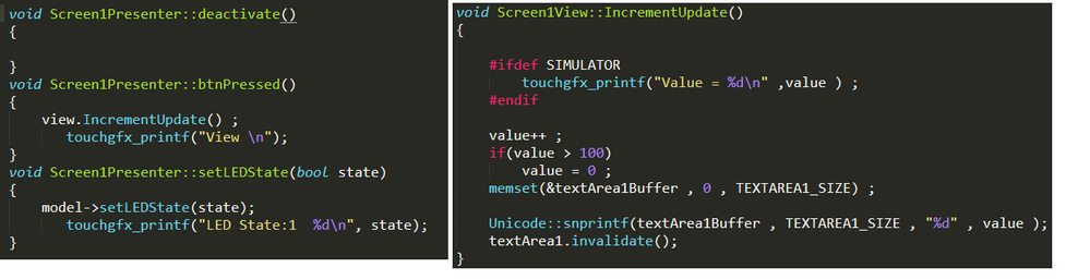

Looking at your model..
walk through it with me.. if you get a message you call btnPressed()
Inside that method you do what? I think you intend to call the 'IncrementUpdate' method in the presenter, but you don't. you call the btnPressed() again? is that right?

@HP (Community Member)
This method works.. Thanks for that ...
@Martin KJELDSEN (ST Employee)
1) Is it mandatory to create "Queue" inside the Model::Model() in Model.c ?
2) If Yes, Why cmsis syntax complied but same HardFault ...
 osMessageQDef(ButtonQueue, 1, uint16_t);
 ButtonQueueHandle = osMessageCreate(osMessageQ(ButtonQueue), NULL);
Or Any other Issue .. Please Update..
