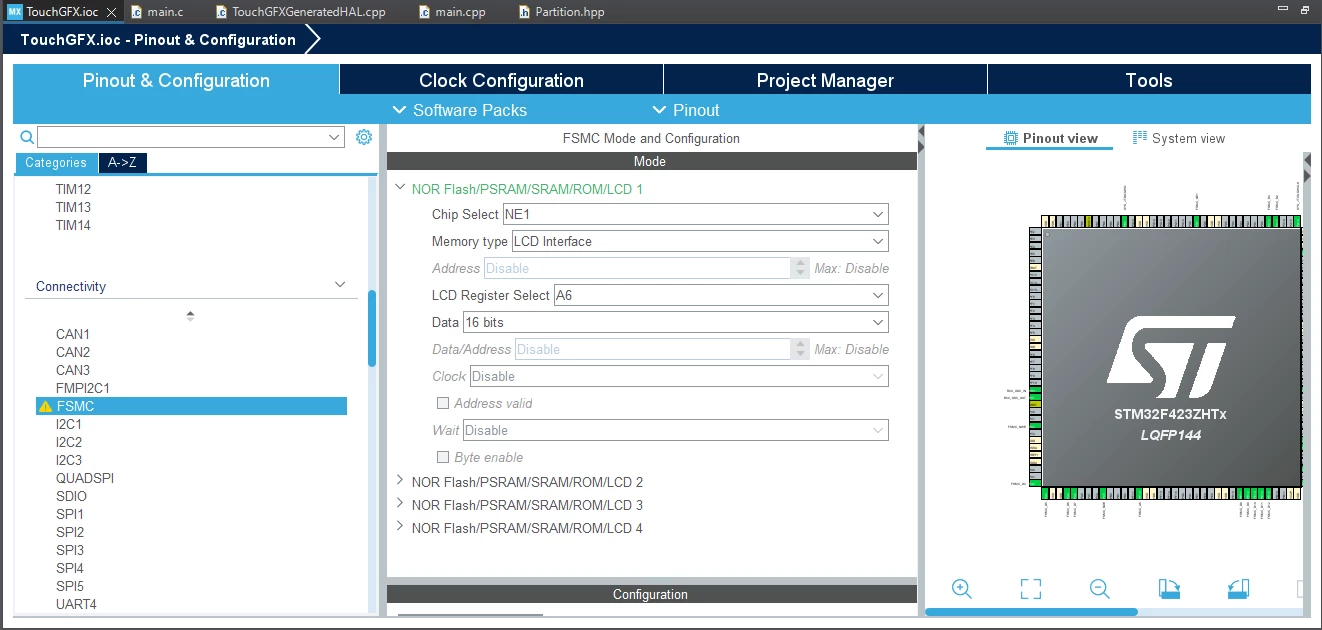

I'm using STM32F423ZHT6 board.

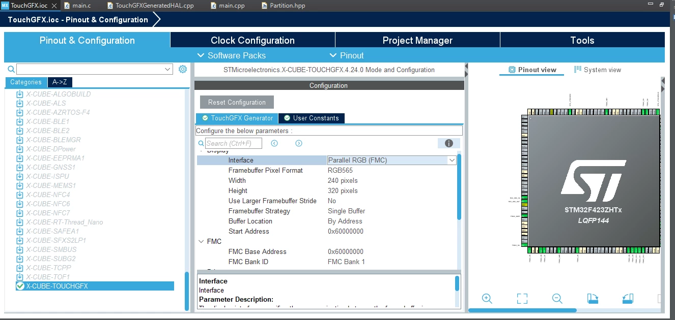

I setup the X-CUBE-TOUCHGFX
And FSMC for LCD interface:

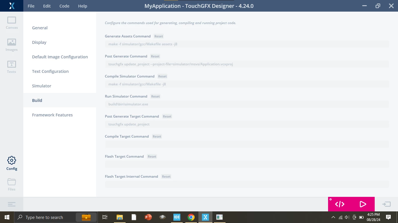

After generate a code. I opened TouchGFX -> ApplicationTemplate.touchgfx.part.
In TouchGFX, I created a boxWithBorder

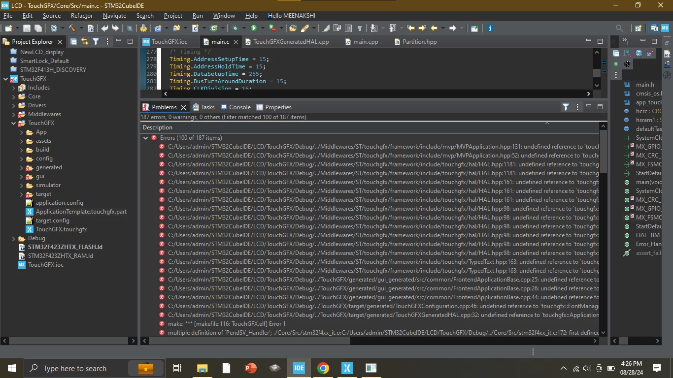

Then Generate code. After Build my project, It shows 187 errors.
Please any one help me to done a project?

Hello @Meenakshi,
Could you post what you have in :
- your project properties ->c/c++ general -> paths and symbols ->library paths
- your project properties ->c/c++ general -> paths and symbols ->libraries

‎2024-08-28 5:25 AM
Thanks for your reply @LouisB. I solved the max errors with the help of https://community.st.com/t5/stm32-mcus-touchgfx-and-gui/how-to-solve-undefined-reference-errors-during-building-a/td-p/98276
But still I got some errors:
