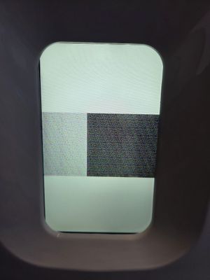

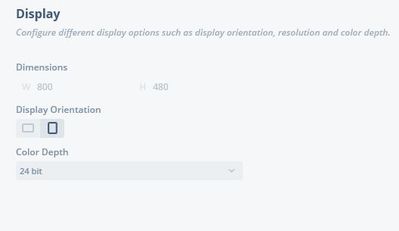

Hi @Osman SOYKURT
Thank you for your reply. That is what I tried, but unfortunately without success. I only see the upper part of the video (probably around 480 pixels) while my display is 800x480 pixels. I use a stride value of 832, not sure if that makes a difference.
I am using TouchGFX 4.26.0.
mathiasmarkussen
Your stride value should not be a problem in this case. I suspect that you are using a video buffer, and that it is set up wrong. I think it should be set to 800x480, and the rendered images are then copied to the framebuffer, where the rotation is applied. If it's already 800x480, I'm probably wrong, and you should try swapping it anyway :)

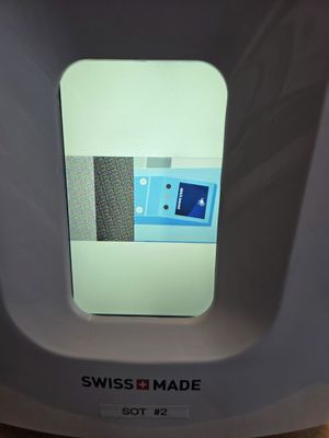

Baldi1879
Hi @mathiasmarkussen
I'm working on this project with @gerthmar.
I made the settings as recomended in the answers to this post.
The result on the device looks like that:
When i tried to swap the buffer width and height, the result was worse than before and nothing of the video gets shown.

I have asked around a bit, and have identified the reason for this.
The STM32F769 is an edge case when it comes to hardware video decoding. For all MCUs with hardware video decoding except the F7, DMA2D can perform a conversion from YcBcR to RGB. This is done into a smaller intermediate buffer, that is then copied and, if needed, rotated into the video buffer.
The F769 DMA2D does not support YcBcR, so this conversion is done in software instead. This code path does not rotate the video before putting it into the final buffer.
If your hardware design is final, and you cannot select another MCU (which I suspect from your images), another option is to rotate you videos at encode time in FFMPEG. I have attached a project that demonstrates how this can be done, and how to modify the video widget in TouchGFX, so it draws the widget with width and height swapped.
Also note that you video buffers do not need to be larger than the largest video you expect to show, and if you rotate the video at encode time, it should match the actual size of the video, not be aligned with the framebuffers as you have them now.
Read readme.md in the project, it is pretty well described there, and let me know if you have any further questions.
