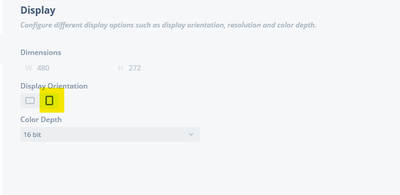

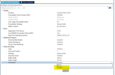

Osman SOYKURT
Hello @gerthmar ,
The rotated video is indeed something we implemented on TouchGFX 4.25.0.
2 things are needed to use it :
  • change the display orientation in touchgfx to portrait
  • change the video orientation in STM32CubeMX to rotated
With these 2 changes it should be working.
