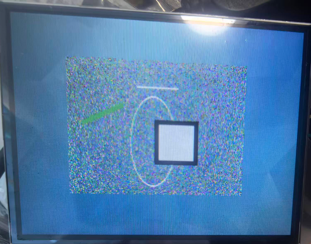

I have tried your solution,but didn't work.
Here is my code structure:
static LCD32bpp lcd32;
Screen1View::Screen1View()
{	tickcount=0;
	dynamicBitmapRGB565 = Bitmap::dynamicBitmapCreate(768, 768, Bitmap::RGB565);
	HAL::getInstance()->setAuxiliaryLCD(&lcd32);
	dynamicBitmapsFace = Bitmap::dynamicBitmapCreate(200, 150, Bitmap::ARGB8888);
	hdgFace.setCacheBitmap(dynamicBitmapsFace);
	hdgFace.enableCachedMode(true);
	hdgFace.updateCache();
	rotator.setBitmap(dynamicBitmapsFace);
	rotator.setWidth(200);
	rotator.setHeight(150);
	rotator.setBitmapPosition(0.0f, 0.0f);
	rotator.setVisible(true);
	rotator.invalidate();
	HAL::getInstance()->setAuxiliaryLCD(0);

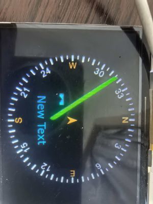

It should look like this:
but instead it looks:
hdgFace is a cacheable Container size 200*150. these two lines,one circle and one box with border are drawn to hdgFace.the box with border looks normal,but the other object is only half size on X axis.

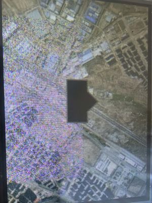

Hello @JohanAstrup
Thanks for your kind reply.
I tried your code,It works but only partly.
Half of the display is good,the other half have random pixels on screen.
amb
Senior
Hello @JohanAstrup
I finally make these random pixels disappear,by using  memset()  before render.

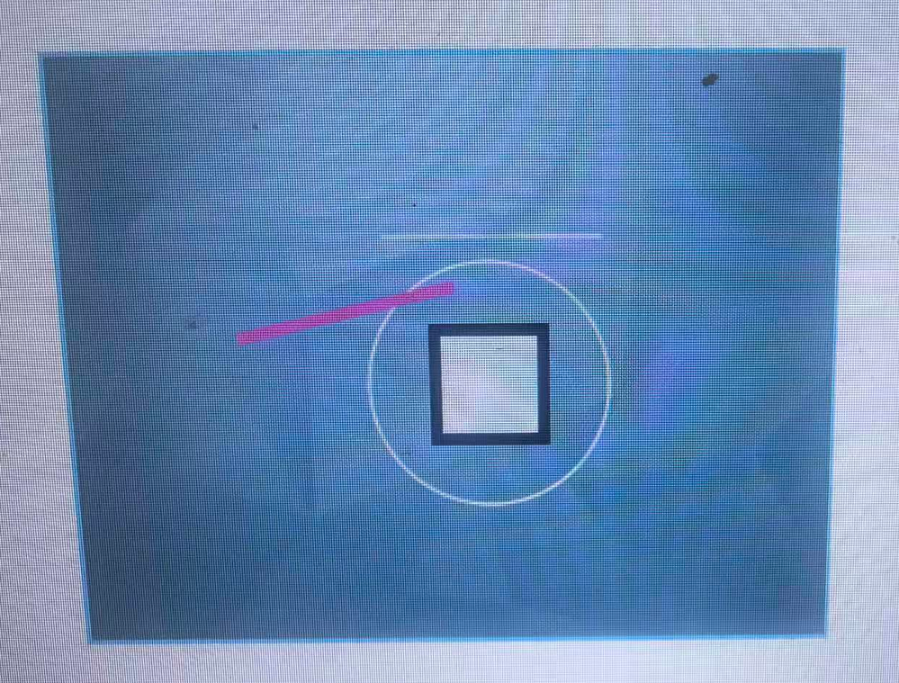

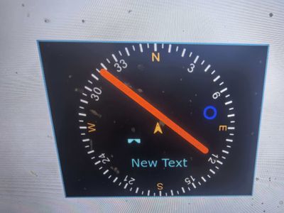

But then I found another problem.
this is what I want:
but after download I got this:
if you put a image into the container(using dynamic bitmap ARGB),then it shows correctly,but if you draw a line or a circle,it shows wrongly, and the circle does not draw at all.
Line color changed.Line position and length changed.
Based on these problems,I think there may be some bug in touchgfx core code.
What can I do to make it right?
Hope for your reply.
JohanAstrup
Hi amb.
Great that you were able to make it work!
The reason Canvas widgets do not work is that TouchGFX Designer does not know about your 32bpp LCD class. Therefore, only the default RGB565 painter is generated, and you must manually set a new painter when using ARGB8888.
I have updated and attached the previously shared example with a Line widget.
In Screen1ViewBase.hpp, you can see that TouchGFX generates the following code:
touchgfx::Line line2;
touchgfx::PainterRGB565 line2Painter;
As you can see, this is an RGB565 painter.
To overwrite it, include the following header in your view:
#include <touchgfx/widgets/canvas/PainterARGB8888.hpp>
Then, in e.g. setupScreen, write the following code:
// Modify painter color format for line2
PainterARGB8888 line2PainterARGB;
line2PainterARGB.setColor(touchgfx::Color::getColorFromRGB(0, 255, 30));
line2.setPainter(line2PainterARGB);
The reason not all painters are always generated is to limit code size. However, this results in this less optimal solution when Canvas widgets are used in a dynamic bitmap with a color depth different from the framebuffer.
