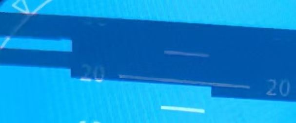

I have a hmi project using stm32u599 and touchgfx,I use RGB565 lcd and double buffer,totally in sram.Recently,I noticed there is some thing flick on my screen,it appears very short time,but still noticeable.This phenomenon appears only a week,I managed to take a snap of screen and here it is:
the dark part of the picture is what appears on screen. position and shape is fixed every time. there is no resource like this in my resources.

Found a solution,add lockDMAToFrontPorch(true); to touchgfxHAL.cpp. Those black blocks disappeared,but frameRate drops from 30fps to 20fps.So I increase ltdc clock from 16Mhz to 20Mhz,frameRate now at 26fps.

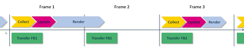

I read the touchgfx document, when using double buffer,the buffer should be trasnfered to lcd (when using ltdc,swap buffer address) when this buffer is completely rendered,this should avoid any tearing or unfinished image.like this:engine-cycle-2fb-long-render.png
But my render time is about 38ms, LTDC still running at 60Hz,16.7ms. So render time crossed 3 frames(frame 1-3).If buffer is swaped after totally rendered,the fps should be 20,not 30.But before I add "lockDMAToFrontPorch(true);" my fps is 30,that means touchgfx swaped buffer at frame2 end.After I add "lockDMAToFrontPorch(true);" ,touchgfx swaped buffer at frame3 end instead, that results a 20Hz fps.
After I increased ltdc clock from 16 to 20Mhz,now ltdc frame is 60/16*20=75hz,that is 13.3ms. Render time 38ms still crossed 3 frames, that results a fps of 75/3=25hz. This also fit 26hz I measured before.
Yes,you are right , I have textureMapper on the  background, so each frame should be redrawn entirely because this textureMapper is the deepest layer.
