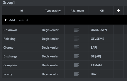

I want to set textarea. I created the new texts.

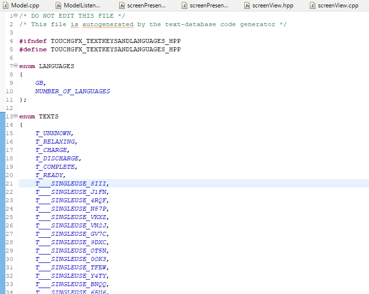

BT4_Status_Value_Text buffer is 25 byte. When I compile the program it doesn't give any errors. But when I load, program is doesn't work.TFT screen and other hardwares (canbus, status led etc.) is not working. If I assign any text id directly to "bat4TextId" the program runs and I see the text I assigned on the screen.
void screenView::updateStatusText4(touchgfx::TypedTextId bat4TextId)
	bat4TextId = T_CHARGE;
	Unicode::snprintf(BT4_Status_Value_TextBuffer, BT4_STATUS_VALUE_TEXT_SIZE, "%s", touchgfx::TypedText(bat4TextId).getText());
	BT4_Status_Value_Text.invalidate();
All text ids are defined in TextKeysAndLanguages.hpp.
I think I can't link the Bat4TextId with the bat4TextId in presenter. What's the problem?

Does it happen for every text? I see some characters that are not standard roman characters, maybe they could be causing the issue?

I edit the data read from the canbus in the model file and display it on the screen. As you said, I can do it using snprintf. However, sticking to the MVP structure, I want to process all the screen data in the model file. If I do the assignment using a switch-case inside the model file, that is, if I assign a value to the 'Bat4TextId' variable within model::tick, the system crashes (screen refresh, LEDs, buttons, everything crashes). However, if I assign a value to the 'bat4TextId' variable within screenView (inside updateStatusText4) (regardless of whether it's GEVŞEME, ŞARJ, or DEŞARJ), the assigned text appears on the screen, and the system continues to operate normally.

what if you remove the switch statement and make some kind of toggle that changes the text id in model to see if it works, also what if you directly put the variable into updateStatusText4? (so every 100 ticks text id changes with no relation to CAN variable, set directly); to see if that works with no CAN variable.
Are you certain it crashes exactly on the line where you set the Bat4TextId to a value? Can you set a breakpoint in model::tick member function and step over to see where it crashes?
