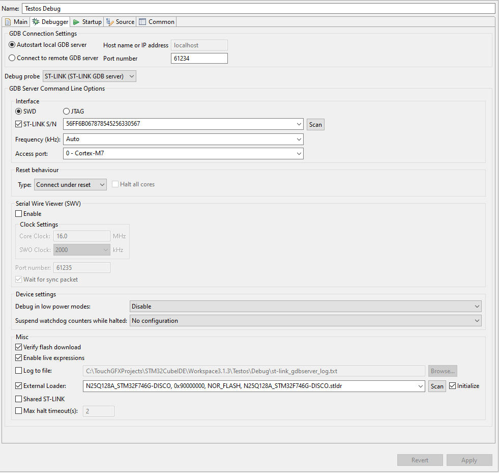

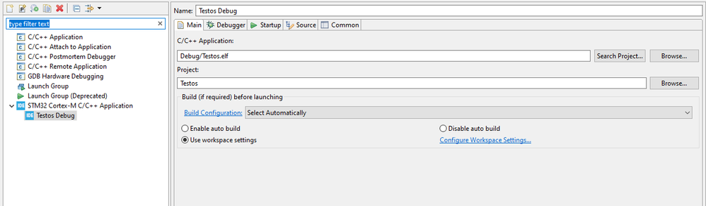

I was trying to find a step by step tutorial on how to import a Project using TouchGFX Designer with a given template (e.g. STM32F746G Discovery Kit), using some matching UI Template, generate code and afterwards import the project into STM32CubeIDE.

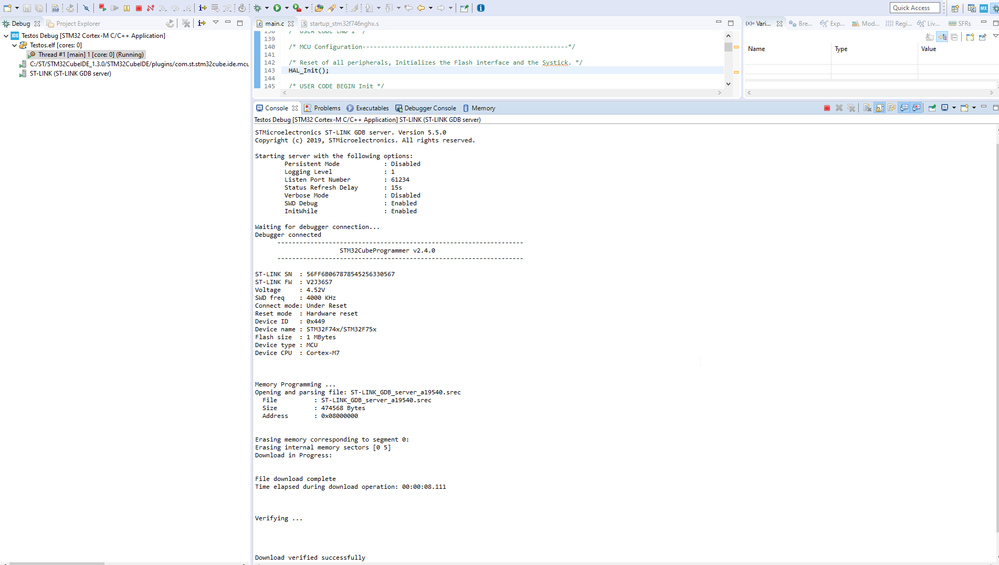

Finally build the project inside STM32CubeIDE and debug / flash it via ST Link V2 onto my board.
Unfortunately I end up with a Black screen + some Background light.
No Errors during the build, connect to ST Link V2 Debugger and flash.
