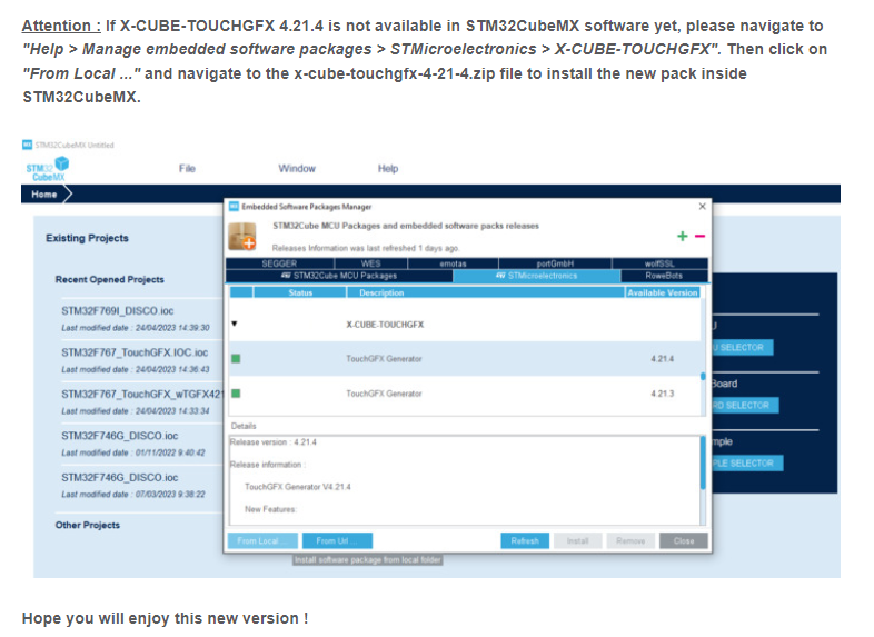

‎2023-05-08 6:43 AM - edited ‎2023-11-20 9:05 AM
Hello @MPath.4​,
You can manually install the generator, by following the steps described at the bottom of this post.
/Yoann
