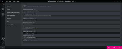

I'm using STM32CubeMX and Visual Studio Code.
After generating a CMake project with X-CUBE-TOUCHGFX selected using STM32CubeMX, I then go to the .part file to create a UI, but when I click Generate Code it shows this error:
Generate Code
    Generate
        Done
    Generate Assets
        make -f simulator/gcc/Makefile assets -j8
        Reading ./application.config
        Reading ./target.config
        Done
    Post Generate
        touchgfx update_project --project-file=simulator/msvs/Application.vcxproj
        Done
    Post Generate Target
        unsupported toolchain: CMake
        ProjectManager.ToolChainLocation
        Failed
    Failed

As MM said, TouchGFX is not meant to use CMake directly.
We support GCC, IAR and Keil but you are free to try something else.
If you want to use something else, you might want to have a look at your build settings:
I see that you are using VSCode.
I assume you use the STM32 extension.
At TouchGFX, we have not yet made TouchGFX and Designer compatible with VSCode but you can look at this ST employee who managed to use the Designer's simulator with VSCode using CMake : touchgfx-simulator-development-in-visual-studio-code-with-cmake (2 years old but updated in 2023).

TouchGFX dont support this , but i mean you can disable post target cmd in touchgfx config and simply manage cmake config files manualy. This is for add files to compilation ...
OK, thank you for your help, now I disabled post cmd and it generates without problem, and indeed, when I try to build it complains a lot about "No such file or directory", so how should I modify the cmake config files?

Thank you, I actually found that tutorial, but my ultimate goal is to build with an stm32 project and flash it to a costume board, so it's not quiet fit and needs investigating.
Now my question is becoming more like "How to Set up TouchGFX With STM32CubeMX Generated CMake Project Using Visual Studio Code and STM32 Extension", shall I change this post or mark it as resolved and open a new one instead?
