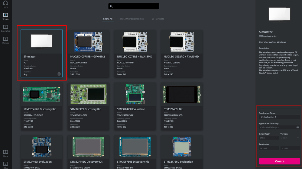

project path is default example path: c:\TouchGFXProjects\MyApplication_1\.
Also the project is empty application:

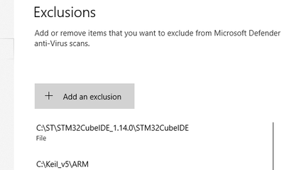

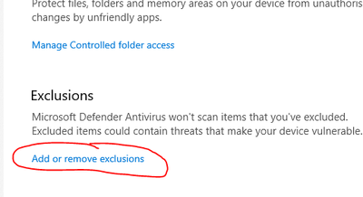

And did you try add project folder to this list ?
And add your folder
