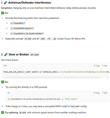

Here’s what I’ve tried so far (none of which helped):
  • Disabled antivirus and security software completely
  • Completly remove and reinstall TouchGFX Designer
  • Run the Make command manually from the TouchGFX environment terminal – the issue presist
  • Tested the same project on another (slower) PC – and it works fine there

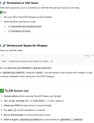

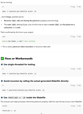

I found a temporary workaround for the delay when running the "Generate Assets" step in TouchGFX Designer.
By default, the command looks like this:
make -f simulator/gcc/Makefile assets -j8
I changed it to:
make -f generated/simulator/gcc/Makefile assets -j8
With this change, asset generation starts immediately, without any noticeable delay.
This isn't a full fix, but it may help others who are facing the same unexplained slowdown during asset generation.

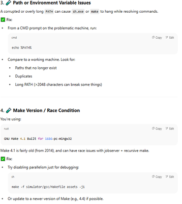

        GNU Make 4.1
        Built for i686-pc-mingw32

        find_and_set_shell() path search set default_shell = C:/TouchGFX/4.25.0/env/MinGW/msys/1.0/bin/sh.exe
