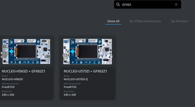

I am looking for a .ioc file to jumpstart a project using GFX02Z with a nucleo-f767zi board.
Can anyone help?
Thanks in advance!

I recommend you use STM32CubeMX to configure your project by selecting the Nucleo-F767ZI board and configuring the necessary peripherals.
There are a specific guidances about how to create and configure a TouchGFX project :

Hello @sesh ,
Unfortunately there is no TBS for that config but you can inspire from one of the boards starting from TouchGFX designer: NUCLEO-H563ZI or NUCLEO-U575ZI:
