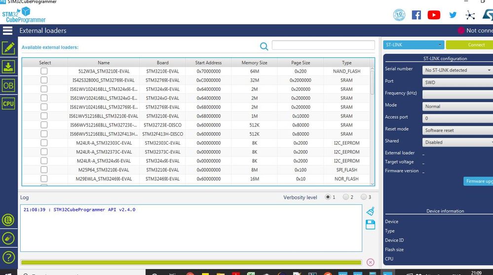

Also I can see external loader option in IDE STM32CUBE programmer. Not sure if this can help.
‎2020-08-03 10:04 AM
Sure, it would need an external loader which is compatible with your board (ie chip, clocks, wiring, etc)
