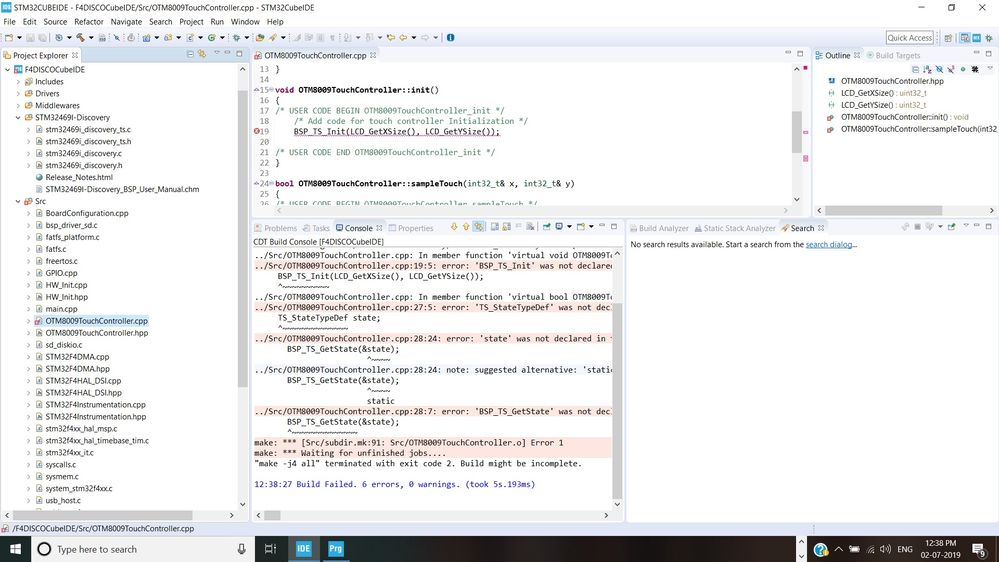

When Compile STMF4DISCOCubeIDE in github
i got the Error
How can i solve that ?

../Src/OTM8009TouchController.cpp: In member function 'virtual void OTM8009TouchController::init()':
../Src/OTM8009TouchController.cpp:19:5: error: 'BSP_TS_Init' was not declared in this scope
BSP_TS_Init(LCD_GetXSize(), LCD_GetYSize());
../Src/OTM8009TouchController.cpp: In member function 'virtual bool OTM8009TouchController::sampleTouch(int32_t&, int32_t&)':
../Src/OTM8009TouchController.cpp:27:5: error: 'TS_StateTypeDef' was not declared in this scope
TS_StateTypeDef state;
../Src/OTM8009TouchController.cpp:28:24: error: 'state' was not declared in this scope
BSP_TS_GetState(&state);
../Src/OTM8009TouchController.cpp:28:24: note: suggested alternative: 'static'
static
../Src/OTM8009TouchController.cpp:28:7: error: 'BSP_TS_GetState' was not declared in this scope
make: *** [Src/subdir.mk:91: Src/OTM8009TouchController.o] Error 1
make: *** Waiting for unfinished jobs....
"make -j4 all" terminated with exit code 2. Build might be incomplete.
20:12:01 Build Failed. 6 errors, 0 warnings. (took 15s.552ms)
‎2019-07-02 12:53 AM
You have to include touch related .c files in your project for compilation. _discovery.c, _ts.c, i believe, from the cube firmware pack.
/Martin
‎2019-07-02 11:15 PM
Already Included
Here i enclosed the Image
‎2019-07-02 11:59 PM
Yeah, those methods are a part of the Discovery Firmware pack. You need to add it manually ( _discovery.c and _ts.c). Also the include path, of course.
/Martin
