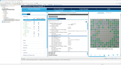

Ensure first you activated the default MPU configuration to prevent CM7 speculative access for invalid memories,
Then you need to enable the MPUs for the external memeories you are using.

As suggested, I have enabled the default MPU configuration, and I have also added MPU regions for the external memories used by TouchGFX, but problem remains even after enabling MPU.
Below I am attaching:
- CubeMX MPU configuration screenshot
- My full MPU_Config() code
- A video link demonstrating the flicker / corrupted-screen issue
