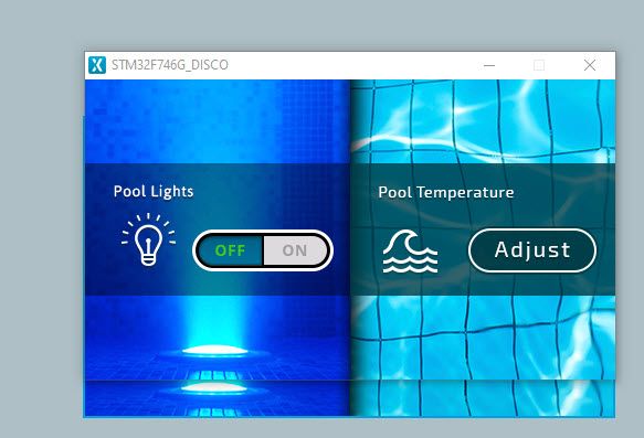

Ok. Just installed the support files for the same target STM32F746G_DISCOVERY kit -> after this installation, the TouchGFX simulator ran fine. Took less than 5 minutes but numerous support files were downloaded in the background. Very impressive toolchain as of this latest review. We can review your installation over TeamViewer once you send over the credentials.

3) After completion, important that the STM32 Cube IDE can build this wizard generated basic project. If it does not build, the TouchGFX will also fail. That is our experience.
4) After this proper build, the TouchGFX was still failing but we observed the log of the compilation and the developer has spaces and some characters in the Windows user name foldername. He will now re-install a fresh Windows 10 OS with a short folder name (without these characters) -> then a fresh copy of the ST tools to test again.
My local PC on Windows 10 and a simple folder name is allowing all demo code to compile ok and the TouchGFX (gcc compiler) compiles ok.

@Mon2​ solved my problem with teamviewer. he is very very gentleman and good person. my problem is just windows 10 user name that has space and some character. i reinstalled windows 10 with valid user name. so touchgfx is working fine.:ok_hand:
