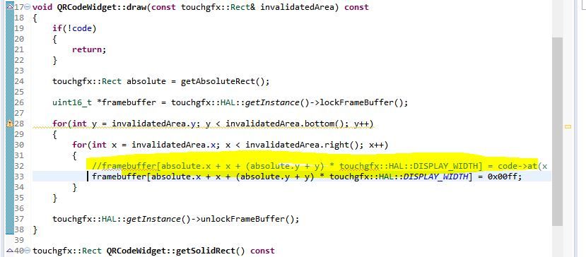

OK, So I did one experiment. I put QRCodeWidget qrCode outside MainScrenView (means like global class) so code stared working without hardware fault and i can able to see one black pixel box on display. But there is one issue. I explained it down.

So there are 2 screens in my project, First screen is logo screen which will go on display during power up and post 1 sec , my main screen will come which has QR code. and this was working fine when I didn't included QR code part.
Post adding QR code(updated one), logo screen started moving after 1 sec but now move is too slow . it takes like 10 secs to shift screen to main screen from right to left.
Not sure. Any suggestion ?
2020-04-29 12:20 PM
Updates:
Issue was with the code written at QRCodeWidget::draw. Seeems like highlighted code was making things slow. I replaced this with dummy value and this started working fine.
