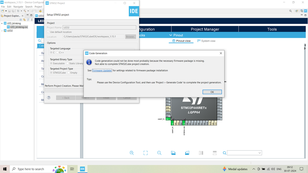

Code generation could not be donemost probably because the necessary firmware package is missing. Not abe to complete STM32Cube project creation. See Firmware updater for settingrelated to firmware package installation.

@Aman1 wrote:
See Firmware updater for settings related to firmware package installation.
So did you do that?

Hello @Aman1 and welcome to the community,
Try to check the connection under Window->Preferences->Firmware updater, then login to myST. The firmware will be successfully downloaded.

Did this worked out for you @Aman1 ? @Rim LANDOLSI following the Window -> preferences->Firmware Updater path I can'
t find any window to log in for myST.

The login is in : menu -> help -> STM32cube updates -> connection to myST
