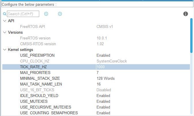

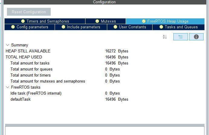

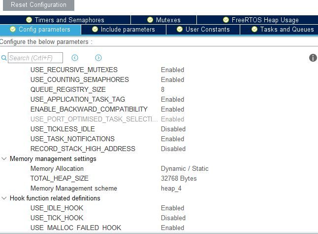

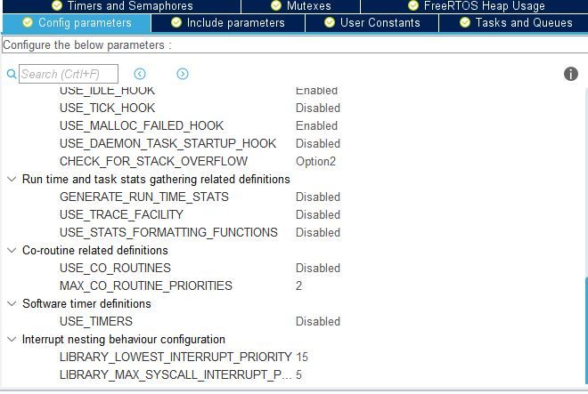

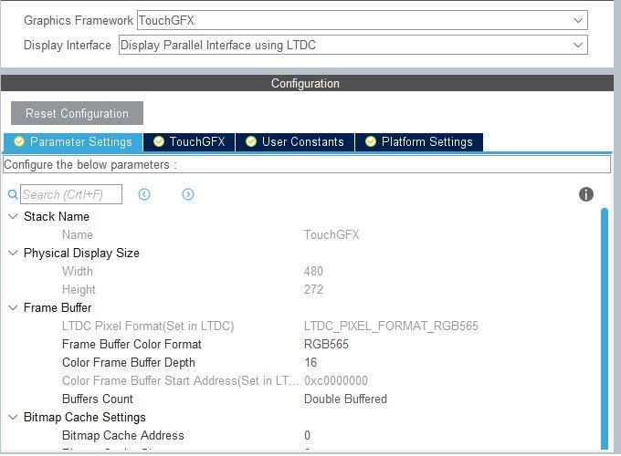

Look in the FreeRTOS configuration in CubeMX to find the stack size.
‎2020-04-29 1:09 AM
Already checked but didn't find it. Below are the images from cubemx.

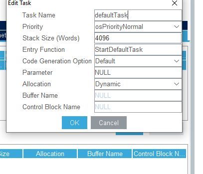

‎2020-04-29 7:06 AM
"Tasks and queues"
‎2020-04-29 7:26 AM
its already 4096 words.
‎2020-04-29 8:07 AM
Is this CMSISV1 or V2 ? For V2, that window is actually wrong. It's no longer in words, but in bytes.
‎2020-04-29 8:09 AM
its CMSIS V1
‎2020-04-29 8:13 AM
Okay you'll have to do some more debugging then.
