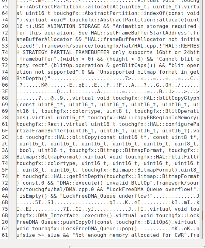

Hello, I know this post it a little bit old, but I'm seeing a lot of code information from the touchgfx library in the microcontroller's binary. I checked optimization, also I stripped debug info, unneeded and other flags, and the same.
Any idea what can be happening?
Here is a picture of what I'm seeing in the binary. I don't think this was compiled as a debug info.
