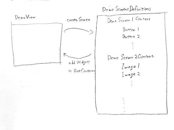

Hello Alexandre,
"I feel like (correct me if I'm wrong) that you want a kind of template. Like the backgrounds, icons, etc... must be shared."
Yes. That's nearly what I want to do, and I think I can solve the problem by the way what you suggest.
Our project is the first one who use TouchGFX for product and I'm creating a demo project for other members who use TouchGFX after us.
However, the demo project is taken over from a predecessor, and the project was designed like this.
When the switch screen was called, all widgets are removed from the Root Container by calling deleteScreen() function and the application calls createScreen() function.
In the createScreen() function, the widgets are initialized and added to the Root Container.

I don't know why he implemented so.​ and I do think I should add screens.
But I don't want to spend much time to modify a demo project, so I asked if there's a way to solve.
That is the situation and what I'm going to do.

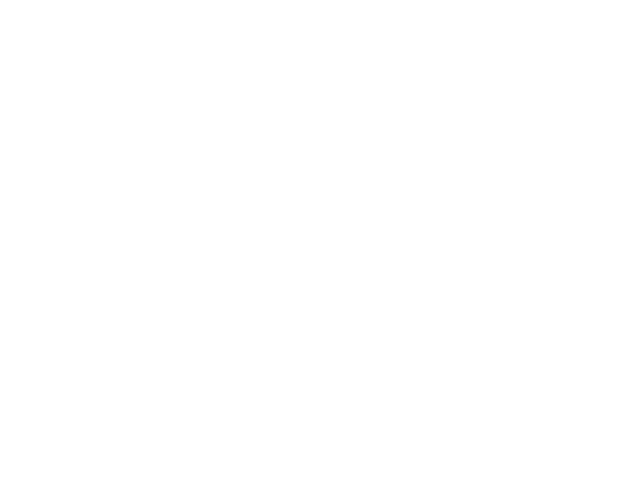

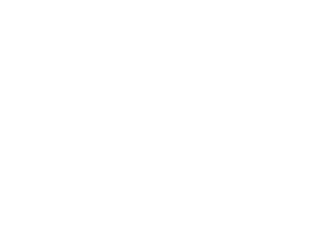

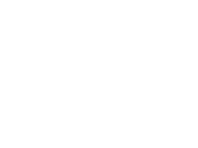

Screen1 Button Demo​ (and some test widgets)
Screen2 Animated Image Demo
​Anyway, I think overriding ClickEvent would be the answer what I wanted.
And I decided to re-design the application because each screen have widgets which receives ClickEvent and the overriden ClickEvent would be too complicated.
Thank you for your advice. It helps me a lot.
