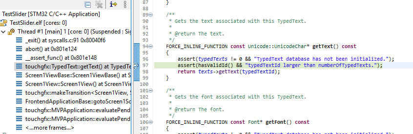

- Elf compiled by STM32CubeIDE does not work.It crashes when initializing the TextArea1 in Screen1ViewBase
Unicode::snprintf(textArea1Buffer, TEXTAREA1_SIZE, "%s", touchgfx::TypedText(T___SINGLEUSE_YO0H).getText());
either by not passing an assertion in touchgfx::TypedText::getText() (assert(IsValidID...) or some other times (I cannot say when) by triggering the MemManage_Handler.

Have you remember to update also external flash after CubeIDE build ? For some reason, external flash content is bit different compared the TGFX designer Target build and CudeIDE build. Empty or TGFX target build content on the external flash causes the assertion failure when running cudeIDE internal flash.
Br J.T

Please, follow the link to get the zipped project.
I also enclose a capture of the stack when running the compiled version from STM32CubeIDE.

‎2023-08-04 12:43 AM
You are right!
I have that in mind when I use the CubePrgrammer to restore the boards to their default demo, but I overlooked it in CubeIDE. Thank you for your help.
