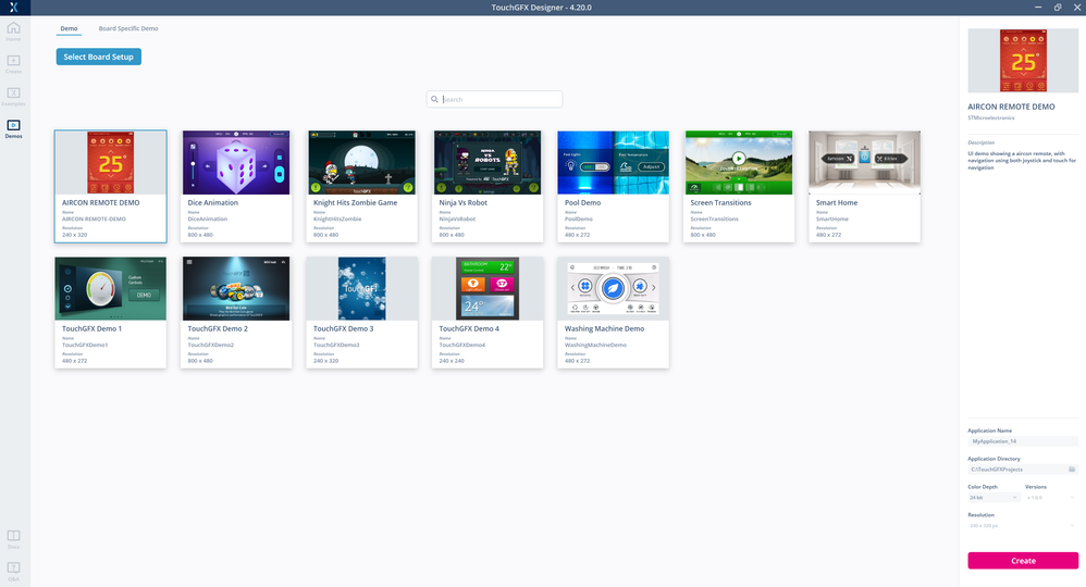

There is the Aircon Demo that can help you understanding how to use HW buttons on your board. Please have a look at that :
/Yoann
